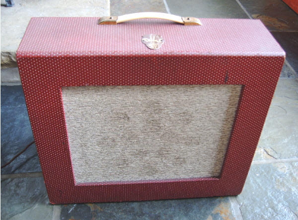

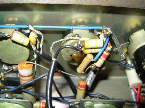

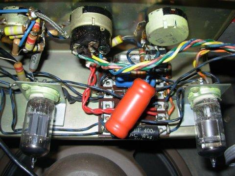

This question is for all the amp gurus out there. I need to decipher a tone stack from a picture, or few pictures. I know most of the resistor values and have an idea how they are connected but not 100% sure. Anyone with a keen eye and knowledge for out of the ordinary and strange tone stack circuits may help me to draw out the schematic for this amp. This is a Dallas Rangemaster 5412 model with tremolo.
The tremolo section will be the next challenge by the way. I attach a few pictures from different angles so you can see and hopefully figure out the circuit. A brief description of the pictures;
The decoupling cap that feeds into the tone stack is a 10nf and appears to connect to the treble pot's top connector. ( The top of the picture is actually the earth leg of the pot!) From where the 10nF connects, there is a 100k resistor connects to a junction of an unknown cap (it's leg looks like to connect to the earth leg of the treb pot) and a 220k resistor. The other side of the 220k resistor joins to another 220k resistor and perhaps to the centre wipe of the treble pot,(this is not sure though!). On the middle of the treble pot there are two 470k resistors, and they are seem to have been joined on the left hand side. This is where the next stage input shielded cable connects. Underneath that there seem to be a small ceramic type cap covered in wax? The topmost 470k resistor comes from the wiper leg of the bass pot through a shielded cable that is shielded (soldered to the treble pot's earth, top of picture.) The bass pot is on the right hand side, and it is the on/off switch at the same time.) It could be 1M or 500k, I am not sure. The bottom resistor of that pair connects to where? Also there is a ceramic cap coming from the top leg of the bass pot and joines to? (it could be the top leg of the treble pot, but this is only guessing.)
The sizes of the two ceramic caps indicate something like 3.9nF or 4.7nF - ish? The wax covered cap is more like the pF range, 100pF maybe?
These are all the components of the tone stack. Can anyone figure out how they could be connected and work? Any help would be greatly appreciated.

The picture doesn't show the pot terminals so it's impossible to see the connections. You may need to disassemble the front panel to get enough visibility.

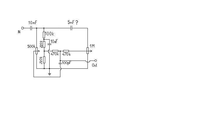

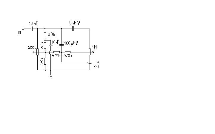

What do you think Wolfgang?
I drew out a schematic, the way I think they are connected. Would it work like this? Or anyone out there what do you think of this schematic?
Laszlo
Hi Laszlo,
it may work but not in a way as I would exspect . Look at your drawing. Assume the wiper of the 500k pot is turned to the ground side. The audio on this point is grounded but there is still a signal path from the input via the 100p cap to the output. The small cap let only high frequencies passing to the output . So we have a low cut .The other way round eg the slider is up to its signal side, there will be an increasing amplitude of the lower components of th signal. The 10n cap form a low pass filter with the 100k and the 220k R´s parallel. But the attenuation depends hardly by the Ri of the driving circuit. It is not an ideal basscontrol. With a low Ri of the driving stage it will be louder but not only the bass.
Similar to the other potmeter with the wiper to its ground, there is no attenuation of the treble the 100 p cap has a quite low xc at it. With the wiper at the high side , it is nearly the same like the other potmeter. The whole signal increase due to the low xc of the 5n cap at low frequencies. ( xc of the 5n cap is 636k at 100Hz) .
I believe there is a wiring fault in the circuit or you did somewhat wrong by tracing the circuit. The circuit should be established like either the E-series or the James circuit as they are illustrated in the Duncan´s tone stack calculator. Good luck by tracing the wiring.

Very good work, thank for all the effort. I did try out the circuit and realised that it doesn't work, especially the treble control. So I went back to the pictures and there is a possibility that between the two 220k's common point and the middle wiper of the treb pot the wax cap should connect like in this picture below.
I will try it out tonight to see if it works.

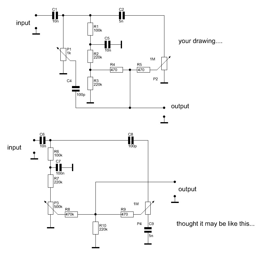

Hi Laszlo,
Id burn some brain cells with this kind of tone control and made my modifications as I thought it could be arranged like this (see attachment) It is, of course a peculiar circuit far away from others.
My rearrangement using all of the existing parts and noone is left over.

Thanks Wolfgang.
I really appreciate all solutions. However I would like to stick to the original as possible. Looking at your drawing, it looks more like a bandaxall circuit, that countless amps use, perhaps with not exactly these values or extra component. Like I said before, this circuit has to work based on the picture. There are not many variation as how to actually connect the part together. Some connections are obvious from the image. Some are either this or that.
Last night I've rebuilt it like the above drawing and finally it started to behave as it should and as I remember when I had the opportunity to listen to the original amp. When you turn on full the treble it rolls off the bass and the sound high, and when you turn on the bass it does the job too. All I have to do now is to work out the best values of the three unknown capacitor values by playing with different ones and listen to the sound. I'm afraid my electronics knowledge is not up to calculating the frequencies, unless you know how to do it and let me know the formulas.

as you wrote there are not much possible variations , but the pictures are not the same like to have the amp on the bench.
The circuit is only a little bit like baxandall, the latter has no low pass filter in it. (ref. obove picture R6, C7,R7)
The behavior of all these passive tone controls are deeply depends on the in/ output impedances of the associated circuts.
You wrote you build the circuit of the obove picture. Did you build your or mine version?
