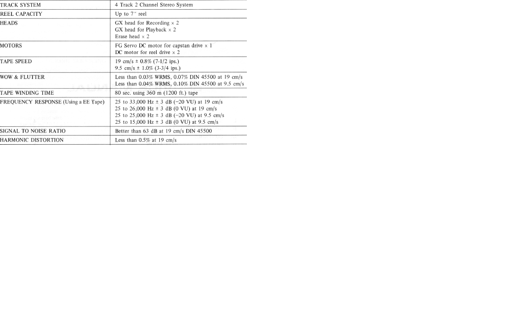

Thanks all guys. I said 15k as the Nak 682ZX and 680ZX I have do have 400Hz and 15Khz tone generators for setting bias. Yes I know most decks use lower frequencies for bias (the Sony TC-K75 I have and the Aiwa AD-6900's I used to have used 8Khz) but 15Khz is most suitable - I have a 482 and a 482X and two Akai GX-77's and 15Khz will be fine for those (the Akai is specc'd out to 26Khz at 0db and 33Khz to -20db).
Yes I know I could use an MP3 player, but this is DIY audio, so It'd be nice to create a simple circuit for it as well 🙂
