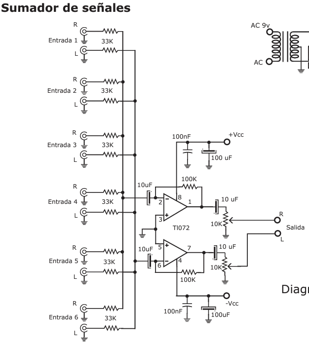

I want to know how to build tone control that have bass and treble control.Example bass control have frequency selector from 10hz to 100hz and booster level. Same with treble have selector 1khz to 10khz. Need help from you all.Thanks

Csom you give to me 3way eq. I want 1 way only.that combine all tone

3) or you are yet to know what a summing amplifier is.
The tone control module was in reality an active 3 way crossover with 3 outputs per channel.
But I used a summing amplifier to mix those output to obtain a high quality stereo output with the help of a summing amplifier.
The summing amplifier "combines" all the outputs.
Again I would advise you to read my thread in detail and try to understand what I have done actually.

Ohh I see . Now I understand function of summing amplifier.you combine 3 way crossover become one way crossover.that first time I know.thank scsom
I have one subwoofer pre amp and one apex stereo tone control that have bass and treble control.Can I combine this two pre amp using summing amplifier? I take this circuit as reference.
Yes you can. But I am not very sure about the result. And that module has no variable frequency range control, that you wanted, as I remember.

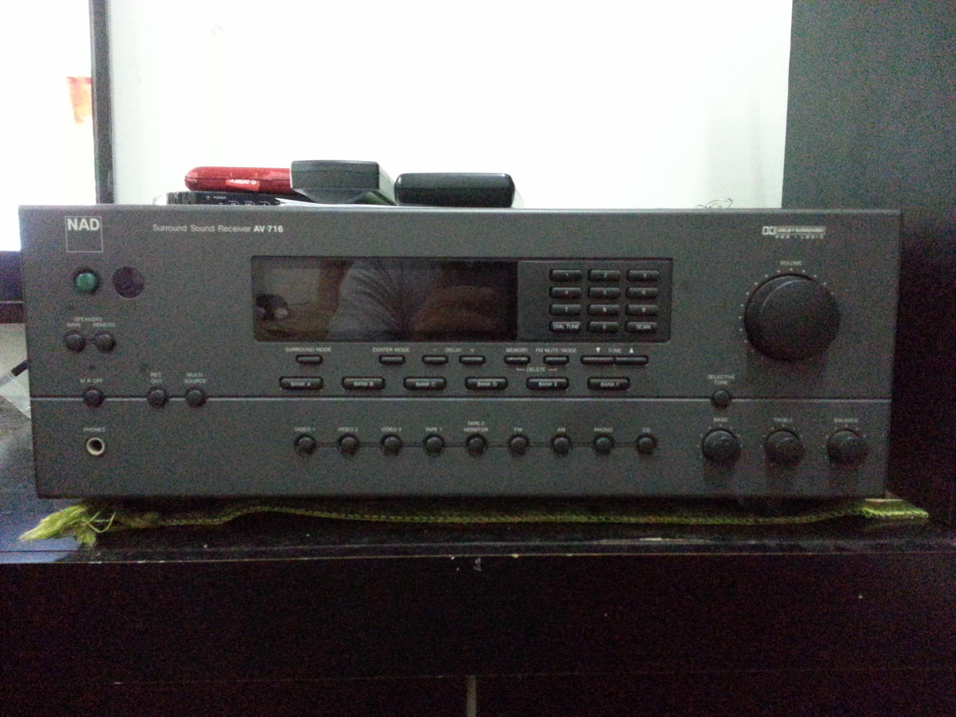

Now I have already build lm3886, hiraga, sr200 (apex), dxblame, stk4050, fidelity amp sj162, but I still not get best pre amp for this amp.The idea to make pre amp after I heard sound from nad av716.this receiver have low bass and deep sound.Thats why I think how to clone nnad quality

7. nad av716.
These are all audio amplifiers or rather great sounding audio amplifiers.

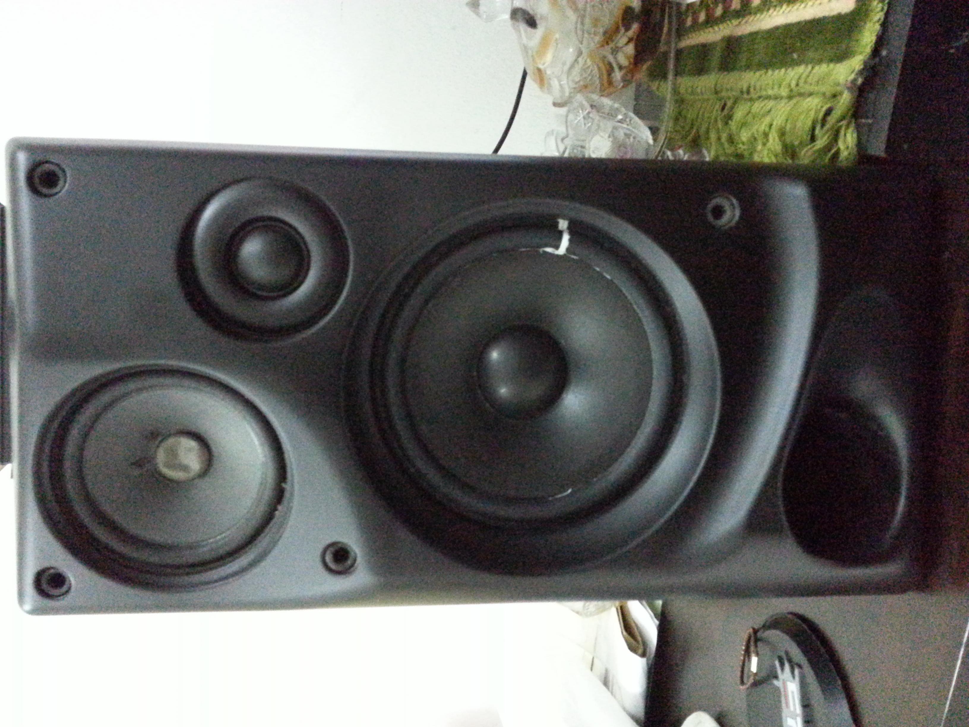

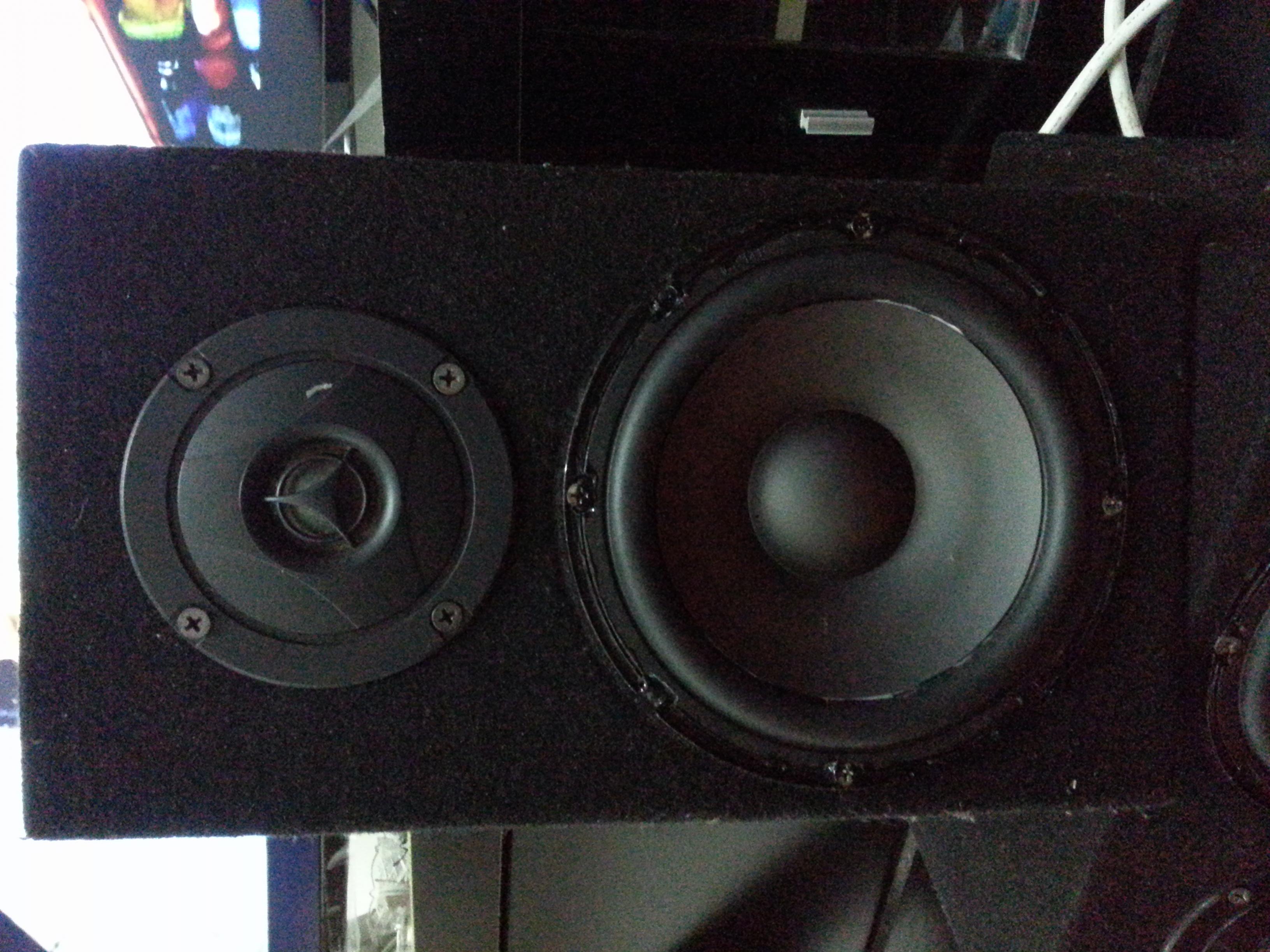

You good listener csom.ok I attach my speaker
1.3Way speaker made in japan
2.2 way diy enclosure driver dls(tweeter no brand)
3.nad amplifier
Thanks to guide and teach me

First speaker is kenwood.csom can u suggest me one design of speaker enclosure.can I use car speaker? Because car speaker more cheap than home speaker.For Now I not use subwoofer.but I have good subwoofer pre amp.but it have humming.i very satisfied with that pre amp.I not like bass from sub.Enough only from stereo speakers.

You are welcome. Your speakers seems okay for me from the outside view.
Though I can't comment on the condition of the x-over.
It is next to impossible to suggest a design without knowing the TSP of the speakers.
First you need to obtain the TSP of your speakers.
Use LIMP to obtain the parameters.
Read/ re-read this thread in detail where other respected members taught me how to build a speaker enclosure scientifically. I learnt from my mistakes there.
