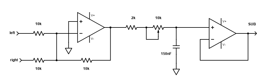

How do I “Make” the sub signal? I would like to merge the left and right signal, and cut off the frequencies above lets say 500Hz. But I would like to be able to adjust the cutoff frequency with a digital potentiometer, so I can control the cutoff frequency with a micro.

With a passive circuit, it would be difficult to adjust the LF sub pole without affecting the gain at the same time.
You could do it actively with a couple of op amps. The pot can be a digitally controlled pot.

Like this. The frequency pot can be a digital pot.

Most likely based on NE5534. Design is close to project#88 from Rod Elliot.
I will include tone control and gain separately on each channel.
Also merging left right channel to a sub with variable gain and lowpass cutoff
All pots will be replaced with digital potentiometers, so they can be set with a micro.
