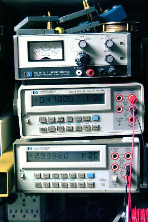

the HP3478A and HP3468A will sell anywhere from $70 to $200. Of these the 3478A has an additional digit. the advantage of the 3468A is that it connects to the HP-IL loop in case you want to connect it to a HP Calculator.
The 3478A is also a very good RMS meter -- while it uses the AD536 chip for true RMS it is almost as acurate as my thermal RMS reading meter. The bottom meter shown below should be reading current -- I was using it to match some transistors yesterday:
