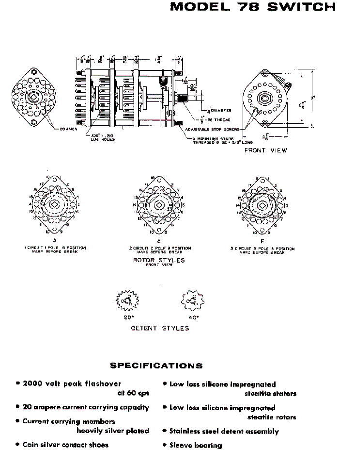

To avoid pops and other noise when switching, I like to use make-before-break rotary switches. These are also known as shorting rotary switches. Toggles are only non-shorting as far as I know. One could even go so far as to use extra sections on a rotary to short out any selection that is not in use. Some say this helps reduce crosstalk, although I've not found that to be much of a problem. You probably don't need to switch the ground side, only the hot side. Small DIP relays are another idea.

There are toggle switches made for high power or electric motors, for a full size switch these will say 10 Amps or maybe 1/2 HP. These types typically have Cadmium contacts and will become noisy. Purists will not like anything other than silver or maybe gold contacts.
Spend a few dollars, buy the right switch (such as from Percy) especially if you're going to drill holes in a nice front panel.

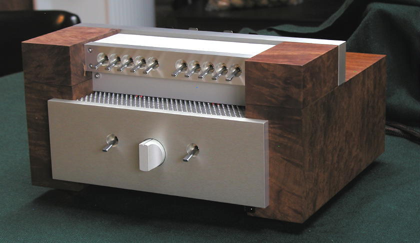

I have for a long time used a DPDT (center off) toggle for input switching, since I and a lot of other guys only have two sources, and a good toggle is one sixth the cost of a good rotary.  I use the E-Switch silver contact, Digi-Key part EG2417-ND.  It's hermetically sealed (for wave soldering, presumably) so I don't worry about degradation of the contacts.  I have had them in use in my own rig for years without any sonic degradation, and I confidently include them in the lifetime warranty on my stuff.  I guess I must like 'em.

With only two poles, doesn't that mean that you have to join all of the grounds? Isn't that bad? I keep reading conflicting things about input grounding.

It certainly is.  The contacts of a switch are carefully designed and shaped, and if the PM plating is of good thickness, the switch will last for tens or hundreds of thousands of cycles operation.  This specification is available in the datasheet under 'cycle lifetime'.
As far as the isolation of individual input grounds; from what?  Each other?  I ground all inputs and outputs to a single 14ga. bus going shortest distance across the back of the chassis, and take that ground to the circuit star point.  I have never in me short life heard of switching audio hots and grounds for individual channels separately, but if that floats your boat, knock yourself out.

Poindexter,
When I first started building amps (chip amps) I thought that keeping the signal grounds separate was a good idea. Found that my amps had ground loop problems. After much putzing around, discovered that my sources and my pre amp had the grounds for both signal channels tied together. I then used the exact method you describe and fixed completely my ground loop problem. I now tie all signal grounds at the RCA inputs at the back of the chassis exactly as you describe.
