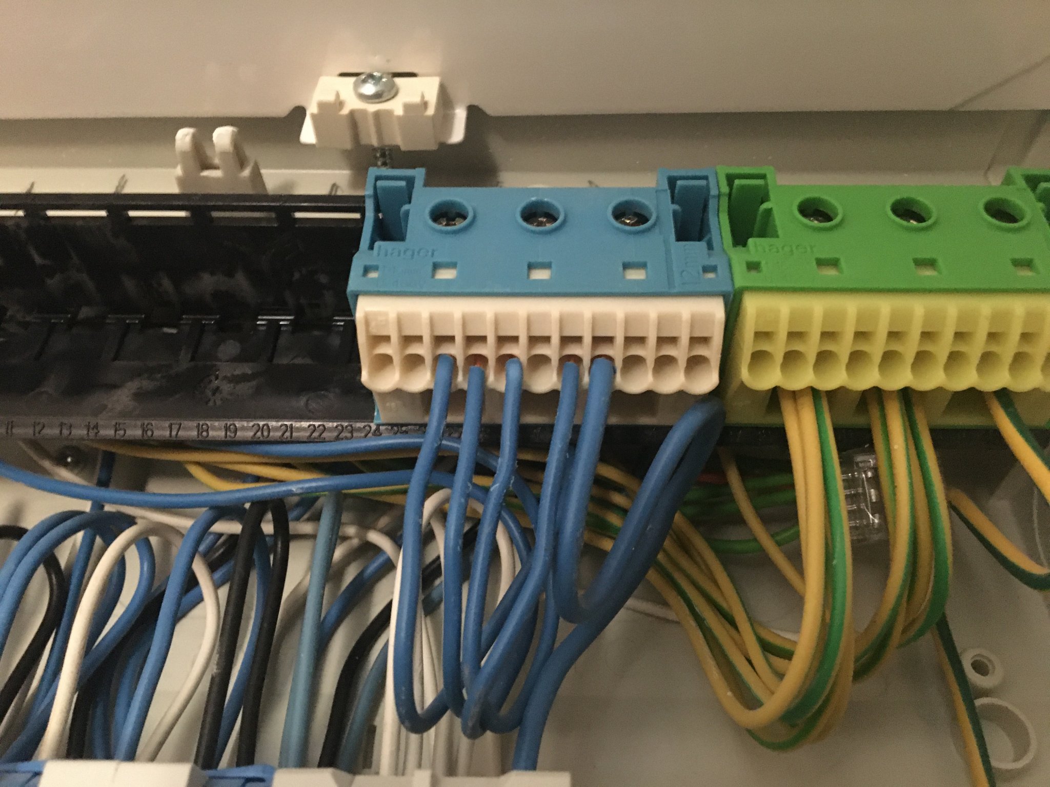

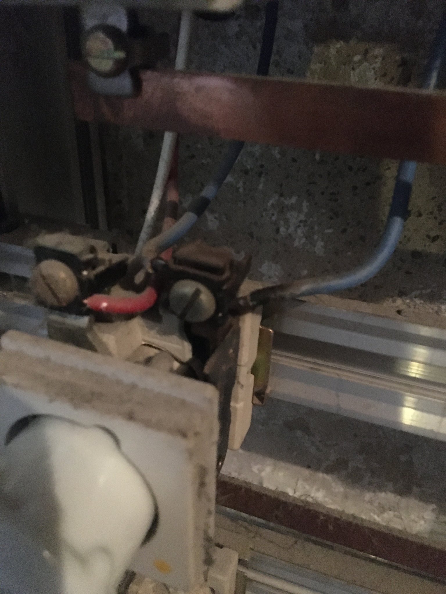

Thanks a lot for all these explanations!
Problem was a neutral line not tightly fixed, which then got another getting hot…
See the earth wires cobbled together into 1 ! hole … ☠️ Incredible.
All but the radio is well again.
