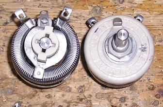

Here is picture:
Here is my own idea.
It is very useful when testing building amplifiers.
Adjustable TO3 Active PowerResistor
Some details:
- Like 10-50 Ohm
- Max power ~20 Watt
- Discrete transistors Op-amp as comparator
- Compares adjustable reference leg, including potentiometer
- with TO3 power leg, including one 1 Ohm power resistor
Connections:
- RED +voltage
- BLACK 0 Volt
- GREY current sense, gives a reading 1.00 Volt for 1.00 Ampere
Enjoy and build the same yourself.
Mine is for DC applications.
Was originally used, to see how much a transformator voltage
would drop at different load.
Used as variable load resistor.
Next project could be for alternate current, AC.
Which could be more useful for some amplifier testings.
Here is picture:
here
You can see how I attached TO3 at bottom.
I have used some isolation material between
control circuit and power transistor.
Gives a little both electrical and temperature separation.
Power transistor is a TO3 BUX39
which I from some old electrical junk I have found and carried home.
For free, of course!
Same goes for the small signal transistors.
They are taken from old circuits - reused.
