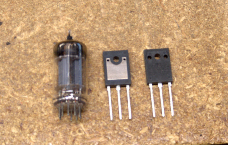

I have blasted through the sil pads too, but I was running about 500 volts on some big Fuji TO247 fets. Made a big bang and fried the plastic on the fet. The fet was still alive but wasn't flat anymore. The bang took out a 2 amp line fuse.
I got some new pads and will try coating them in white goo first. There is no plastic washer on a TO247. The hole is plastic and the metal contact area is spaced away from the hole. I might have torqued the screw a bit too much, so I will try a 6 inch pound calibrated screwdriver. This time there will be 4 fets per big heatsink with only 350 volts. This is for the mother of all driver boards for screen drive and other extreme tube amp experiments.

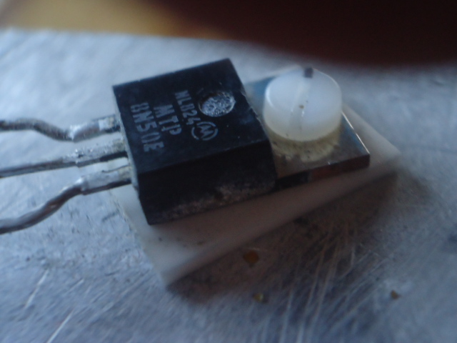

I remember before Bob Widlar's days when the TO220 package came out, I never liked it as this package is sensitive to improper mounting and will pincushion soft silicone pads and needs a hard surface.
I'm surprised some of you don't like the idea of nylon screws or equiv material as shown in pic, for years I regulary use polyamid screws throughout my projects with ceramic washers. Never had an issue with them and their elasticity is a bonus. The trick is to avoid overtightening and also stressing the device with poor pcb mounting and making sure it is dead flat.
richy

Sounds like a TO-247. That's a rather large package. 5-ish mm pin spacing. Used on high wattage MOSFETs and such.
YEP, big mosfets. Big mosfets are usually big capacitors and thus not much use to us tube amp builders, but.....
What can dissipate 195 Watts, handle 7 amps continuous, 28 amps peak, eat 900 volts, and has only 7pF of Crss (the important spec for followers). OH, yeah it only costs $2.40.
I believe that the only place for a mosfet in a tube amp is a follower or a CCS. The only linear mode for a mosfet is a follower, and a mosfet follower can be more linear than a tube cathode follower. I have been using little tiny mosfets for followers to minimize the Crss. You also need to look for a CONSTANT Crss over the voltage range that the fet will see. Well, this big boy is between 7 and 8 pF for any voltage from 40 volts to 900 volts.
What is it....it is a Fuji 2SK3675.
We ran in to a similar breakdown problem at work with TO-220 diodes used at the output of a power factor correction stage. The problem is that there is insufficient isolation between the screw, the tab, and the heat sink using the standard (short-shanked) shoulder washer for high voltages. A solution is to use a shoulder washer with a longer bit that extends all the way through the TO-220 tab into a counterbored hole in the heat sink. That way, one is assured of isolation between all the pieces involved. There are even insulators in the Bergquist catalog with a somewhat larger hole for the longer shoulder washer. All the pieces available through Digi-key (Bergquist, Keystone) for those who care to look. TO-247 parts don't have this problem because of the ring of epoxy around the mounting hole.
Visible in the picture I posted above. This is another reason I like the TO247 parts. Simplified mounting....no shoulder washer needed.
