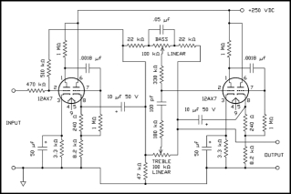

Stefan,
It's a fact that very few recordings benefit from the presence of tone controls. AAMOF, tone controls mess the sound of good recordings up. If you are not prepared to make the tone controls totally defeatable, as in switched out of the signal path when not in use, don't bother building them.
Good tone controls are not at all simple. Refer to the Max Robinson's Baxendal implementation that I've uploaded. That circuitry is "unity" gain, unlike most (all?) of the examples you've looked at, which incur an insertion loss. Now, 4X 12AX7s are a bit OTT for a stereo setup. The bottle count can be reduced to 1/channel and the signal path cleaned up by using DC coupled ZVN0545A source followers, instead of cap. coupled cathode followers.

I agree with Richard and Eli. Well designed speakers and amps should not need dedicated tone controls. If your speakers are consistently to bright on top with various sources and recordings, you can use an L pad on the tweeter or rework the crossover. If you need more bass, consider an active subwoofer with adjustable gain and highpass settings. Once integrated into your room, you won't constantly have to fiddle with it all, and you'll find that good recordings are fine in a "flat" EQ situation. Plus, your signal path remains cleaner.
If you listen frequently on a very quiet volume setting, a loudness control might provide some benefit by boosting bass at low settings. You can get a pot with a loudness tap or use a button or switch to drop in the boost when needed.

I consider tone controls a must, but they have to be done a certain way. I prefer a four section baxandall or equivalent, which is optimized to be able to give you a loudness comp curve that is right when the acoustics of your listening room and absolute level is taken into account. At lower levels you'll want to increase the lower mid and bass, and the high treble. Listening room acoustics usually create significant damage to the frequency response at any listening position. All rooms are different so you want to have better than normal flexibility. I also use a 31 band EQ to deal with lower mid and bass peaks, and flanking drivers to fill in cancellations due to room reflections causing a delayed signal to add at your ear with the direct signal, thereby forming a comb filter effect. To be honest, I probably don't need the 31 band digital EQ at all if I do the flanking drivers right. When it's about enjoying the music, tone adjustment should be an option. If it's more about comparing preamps or monitoring while mixing at a recording studio, there may be times when you'd like to bypass the tone circuit. Flat coming out the speakers is never flat at your ears in most typical living/listening rooms. If turning up the bass makes it sound boomy, the problem isn't the tone circuit, it's the room acoustics. Uneven low frequency response at your ear sounds boomy.
