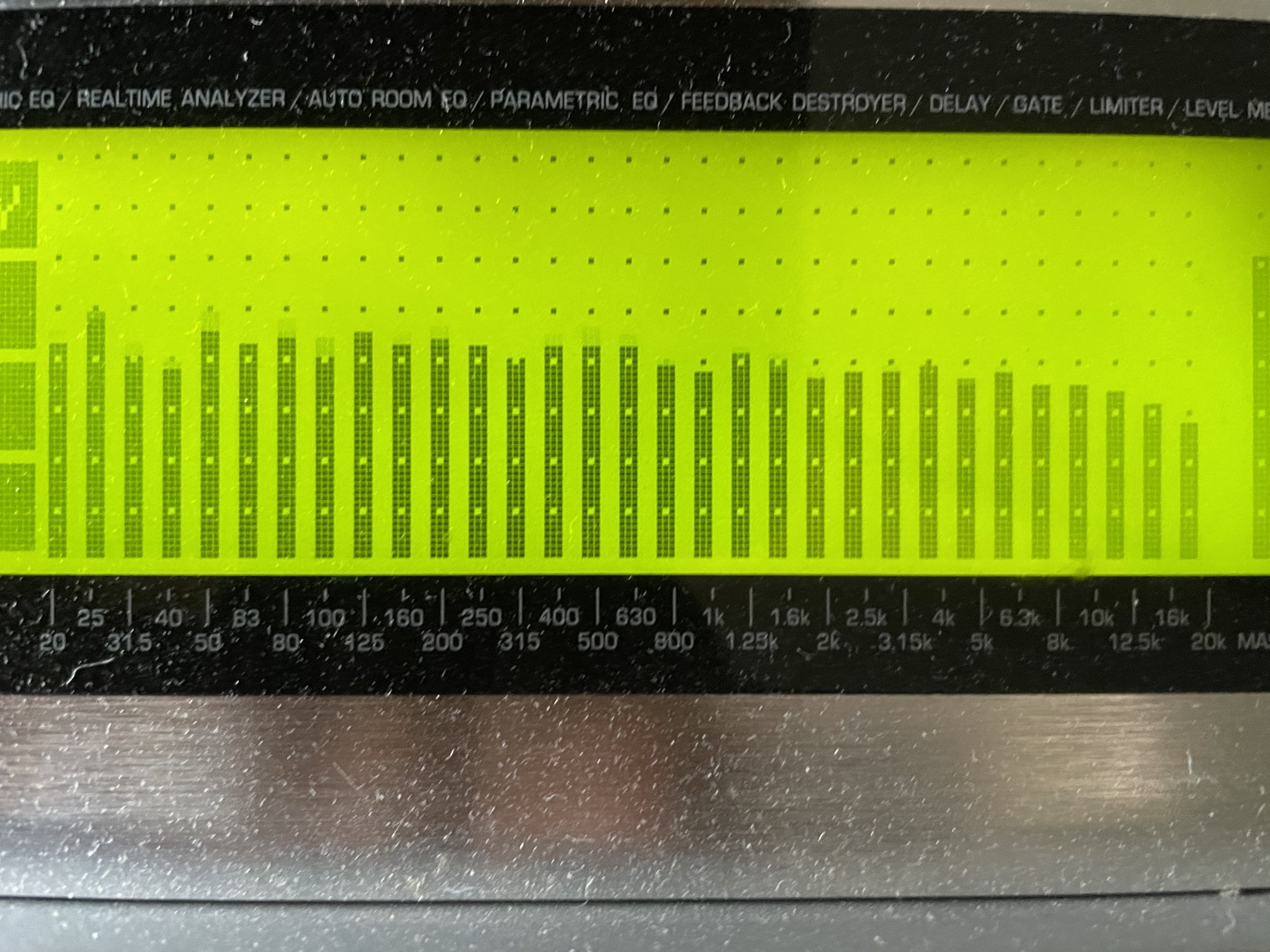

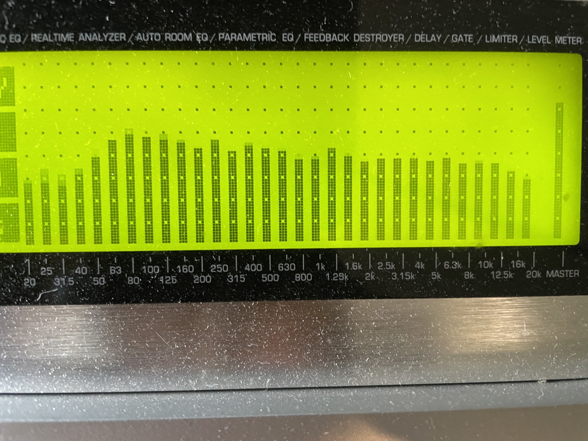

I am able to closely time alignment the sub and woofer at the 70 Hz crossover and I am assuming the woofer drops off sufficiently quickly below 70 Hz (without a high pass crossover) to avoid destructive interference. I have attached 2 RTA two channel pink noise plots at the listening position without sub and with sub added. With no sub the main speaker has a slight bass hump in the 63-126 Hz region. Just adding the sub with no woofer high pass produces a more even response down to 20 Hz. I have an impression that on some music, without the sub sounds punchier, but with the the sub, music such as string bass sounds more lifelike. I need to try the woofer high pass to see if anything changes.I'd vote yes to high pass the mains because even if thier response drops at lower frequencies the output may still combine destructvely with the subs and defeat some of thier effectiveness, so by all means give it a try to see if you like what it does.
This is my first experience of integrating a sub into a music system. I have used full range loudspeakers (2x10" woofers) for the past 20 years and just want to find out if I can get equal or superior results from a more compact 3-way plus stereo subs.

To me that proves that you are experiencing destructive interference with the sub added, if everything was in phase and summing contructively that midbass hump would get higher not lower.I am able to closely time alignment the sub and woofer at the 70 Hz crossover and I am assuming the woofer drops off sufficiently quickly below 70 Hz (without a high pass crossover) to avoid destructive interference. I have attached 2 RTA two channel pink noise plots at the listening position without sub and with sub added. With no sub the main speaker has a slight bass hump in the 63-126 Hz region. Just adding the sub with no woofer high pass produces a more even response down to 20 Hz.
Well spotted. I was scratching my head until I remembered my sub amps are based on ICE modules which have reversed phase outputs. I swapped the sub phase, eliminated the bass peak and now the sub adds without changing bass levels above the x-over at 70 Hz. I also learned the futility of phase matching with single tones at bass frequencies. The room acoustics messes with the phase to make comparisons unreliable. Better to use a wide-band signal (pink noise or pseudo-random noise).To me that proves that you are experiencing destructive interference with the sub added, if everything was in phase and summing contructively that midbass hump would get higher not lower.
