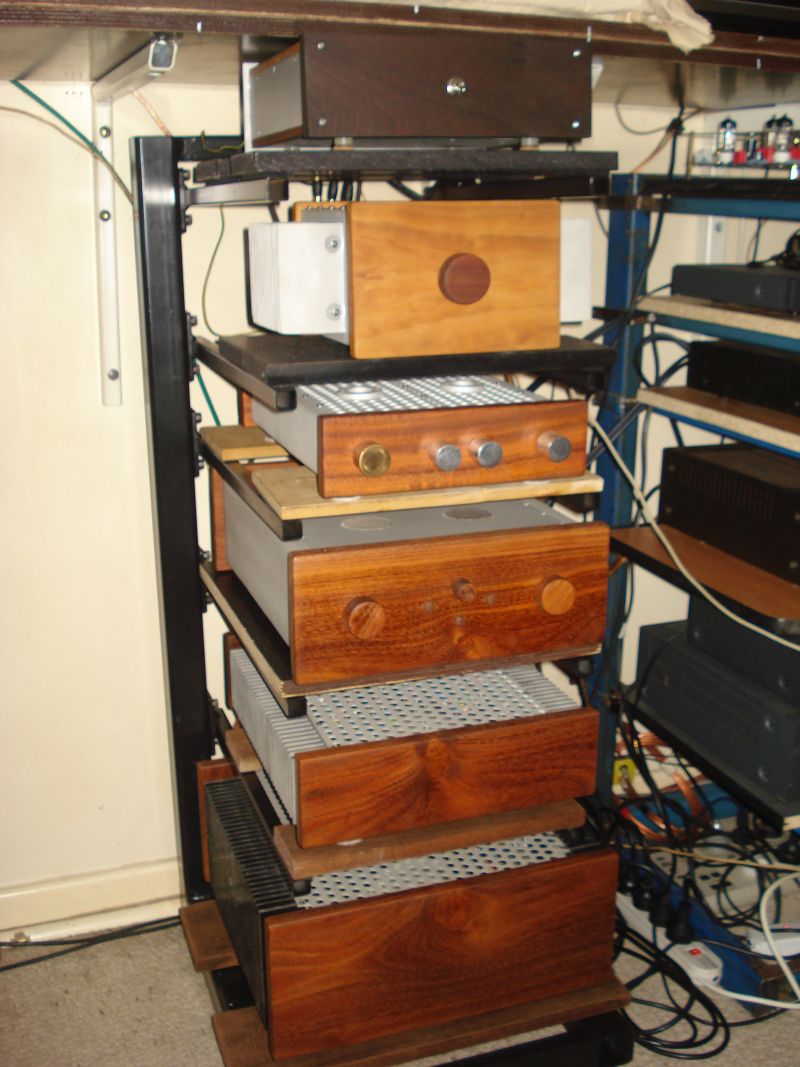

I would advise to not paint. Several years ago (many more than I'll admit 😀) I was wondering the same thing. I had four large natural aluminum heat sinks that I wanted to use for a small class A amp kit I bought. Because they were going to form the sides of the amp case and be visible, I decided to paint them black with some satin black spray paint from the local hardware store. Well, as it turns out, it's damned hard to get spray paint to go between the fins consistently and ended up with an ugly mess. I'm usually pretty good with spray paint, but this was impossible; trying to get the spray in between the fins inevitably ended up in runs and drips and swear words. 😱
Beyond that horror, ordinary spray paint will probably thermally insulate the heat sinks and counter-act any additional heat dissipation that results from painting the surface black.
Anodizing is really the best way to go here.
