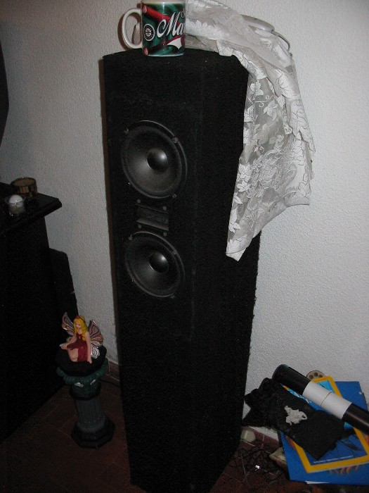

The MMT arrangement 'fouls up' the polar response, keep the tweeter in the middle, do you calculations for the driver spacing. Radius off the baffle edge & keep it narrow.....imaging is spectacular, but keep it up high on-axis best possible to your listening position. You could further apply some absorbent material on the front of the baffle....with all this, group delay will be virtually non-existent.

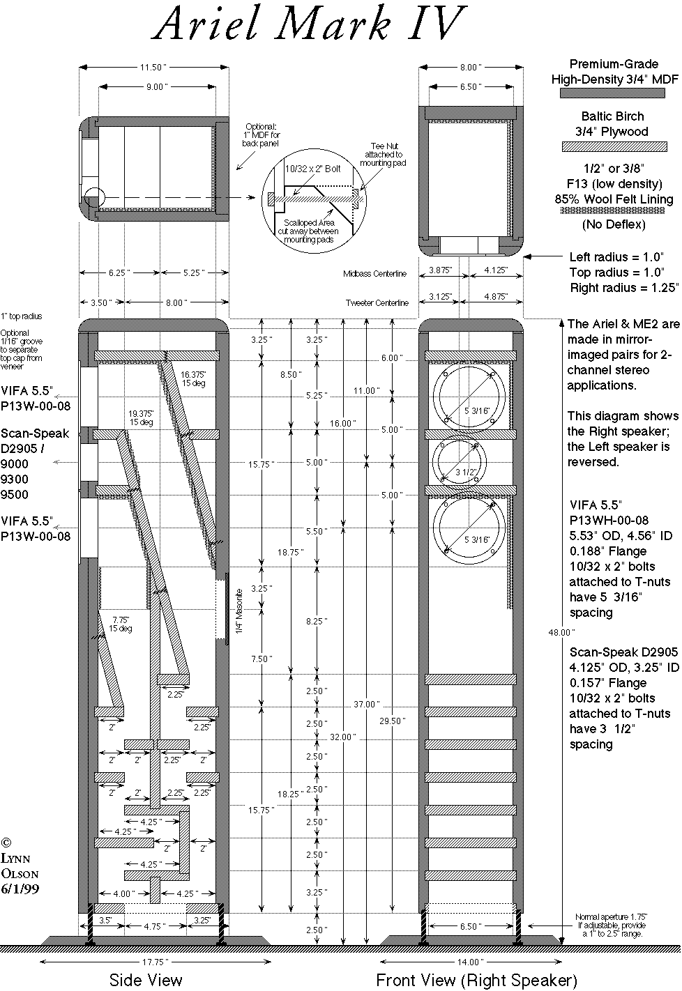

You may have already visited Lynn Olson's project pages plus the ensuing "builders club" pages on the subject of the Ariel (transmission line MTM) and ME2 (bass reflex version).
Consulting these pages would be beneficial for anyone contemplating an d'Appolito MTM configuration. The passive crossover design is very well described, and touches on the manner of overcoming the mid band coloration detected with the d'Appolito arangement.
Ariel Speaker Page
p.s. crossover done around 3.8kHz from the 5.5 inch mid-woofers.

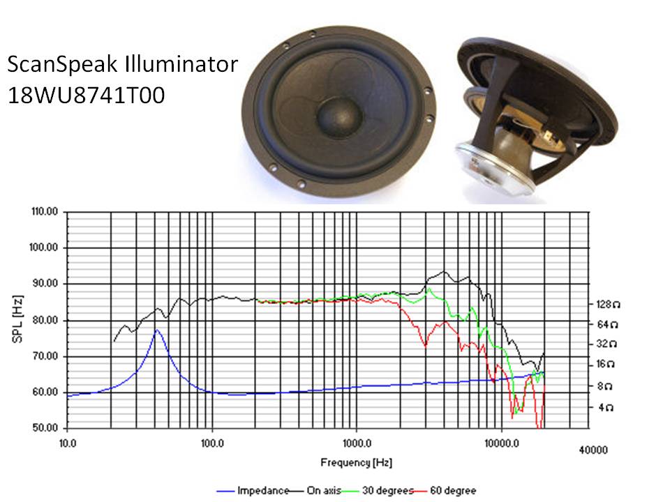

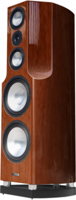

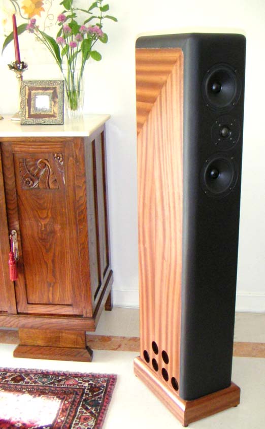

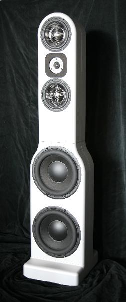

I believe an MTM alignment is best used for either:
1) A two way dual transmission lines or dual MLTLs design as a modern Lynn Olson Ariel. Use 5"-5.5" M and a small diameter T . Keep MTM physical distances as short as possible. Use an odd order crossover 3rd, 5th, 7th. Quater round on all edges to reduce diffraction. Include adjustable baffle step compensation.
2) Using the MTM alignment to increase efficiency to 94-96db/watt as part of a MTM-WW speaker. I think it is worth the effort to build high'ish efficiency speakers.
Personally, I favor TMW or TMWW with a large'ish diameter M like Avalon ISIS 7" M + two 13" W. High'ish 94-96db/watt efficiency goals. A 7" M with a clever cone profile can provide good polar response and modest lobing at 1.5Khz.
