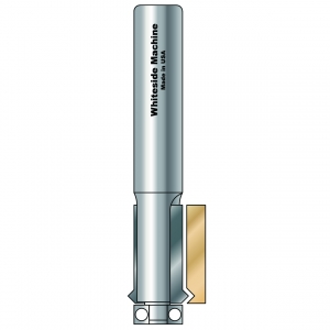

A v groove right on the joint makes it look like you meant it to show. When flush trimming the parts use a router bit like this with the v running down the joint is an easy way. Whiteside V-Groove Flush Trim Router Bits
