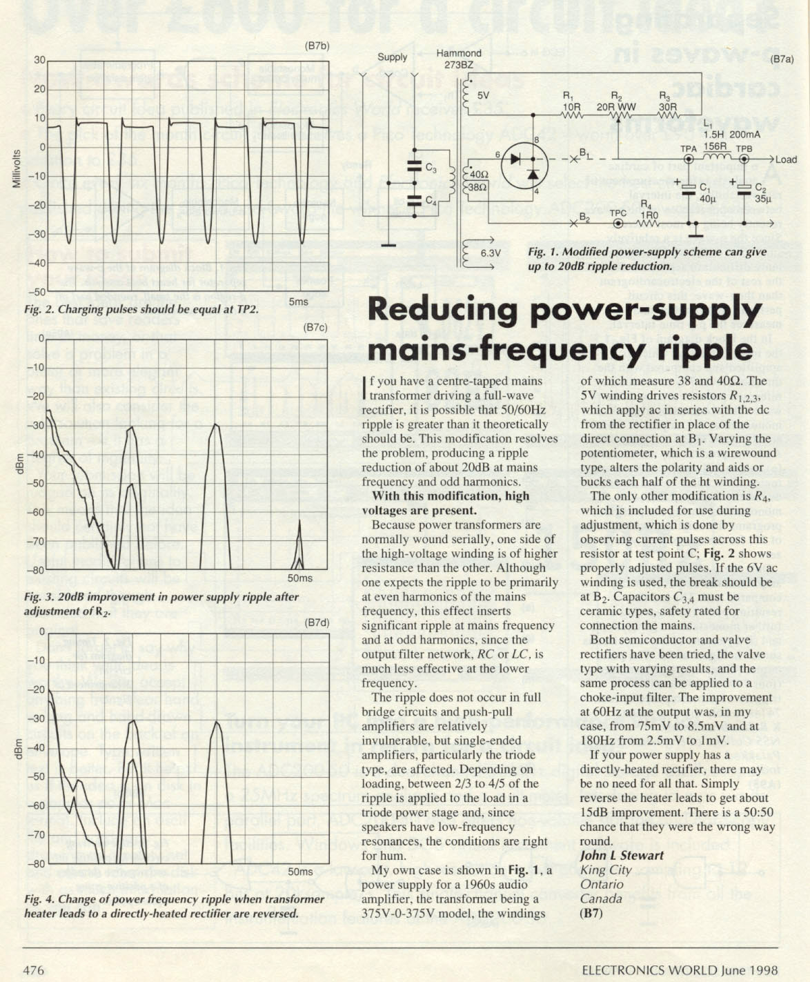

For the serious experimenters & the lurkers, here is a different way to look at ripple. 👍
