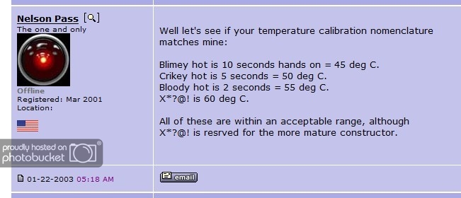

If you can place your hands on the heat sink for 10 seconds without burning it, it's probably around 50 degree C or under. 55 or 60, your hand will feel pain faster.

here is more on the heatsink temperature, from the master himself...
