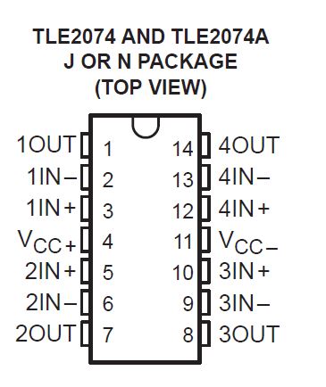

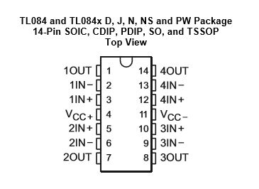

Hi All,
I have an electronic xo and servo circuit board that was built around the TL084 opamps that is very noisy. Using the high pass section in the unit to the HF amp and not using the HF section in the unit is night and day different however I would like to high pass my speakers as intended by the unit.
My concern is the actual circuit and layout is the cause of the noise and not the TL084. However it is easier to try a different opamp first before I go down the path of redesigning the whole circuit and PCB.
Is there a pin compatible opamp for the TL084? The TI website says a replacement is the TLE2074 however it is a different package.
Anyone know of an adapter to an 8 pin dip?

The TLE2074 (Excalibur series) should be a direct swap for the TL084 although I doubt it would make much difference to your problem.
The 084 denotes a quad opamp in a 14 pin package and so I'm puzzled why you mention 8 pin DIP.

Because I am a hobiest and not a professional so I made a mistake (happens often 🙂 )... I should have said 14 pin dip but I was looking at pin 8 on the diagram so 8 pin dip came out.

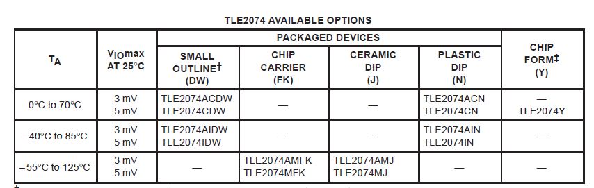

If you don't mind me asking, what is the difference between the part numbers?
tle2074 Stock and Price by Distributor
In the 14DIP package there are various part numbers...
TLE2074CN
TLE2074ACN
TLE2074AIDW
TLE2074IN
Any suggestions on which would be best for an XO and "comparitor" circuit?
TLE2074CN
TLE2074ACN
TLE2074AIDW
TLE2074IN
For general purpose use there will be no difference. Its all in the data sheets, some of there differences are tighter control of input offset voltage over extended temperature ranges.
