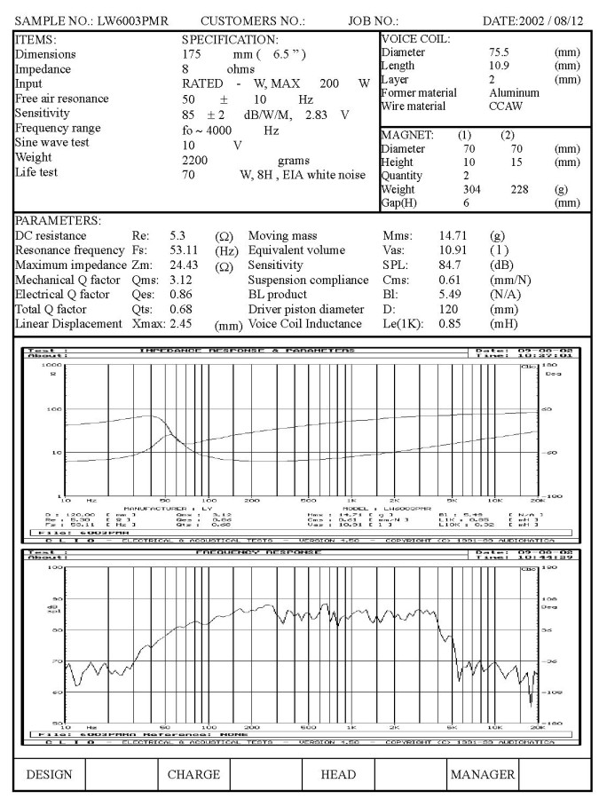

I need your help. I want to build a MTM TL speaker, with Lyeco 6,5" LW-6003PMR drivers, 2 piece/box. What kind of box type you would recommend this drivers? Classic TL(tight), MLTL, or TQWT. Can anyone help me, the box/plan design? I think, I know calkulate ClassicTL. How can I calculate MLTL, or TQWT? On paper, not with miracle programs.
