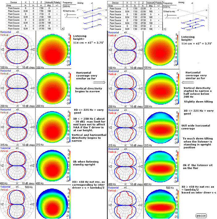

FYI,
Polar plots for 4 OB: s in point source arrays can be seen in the picture 1(1). Observe the polar plots show only the first wave front from the arrays and only localisation conclusions can be discussed.
b
1(1)
