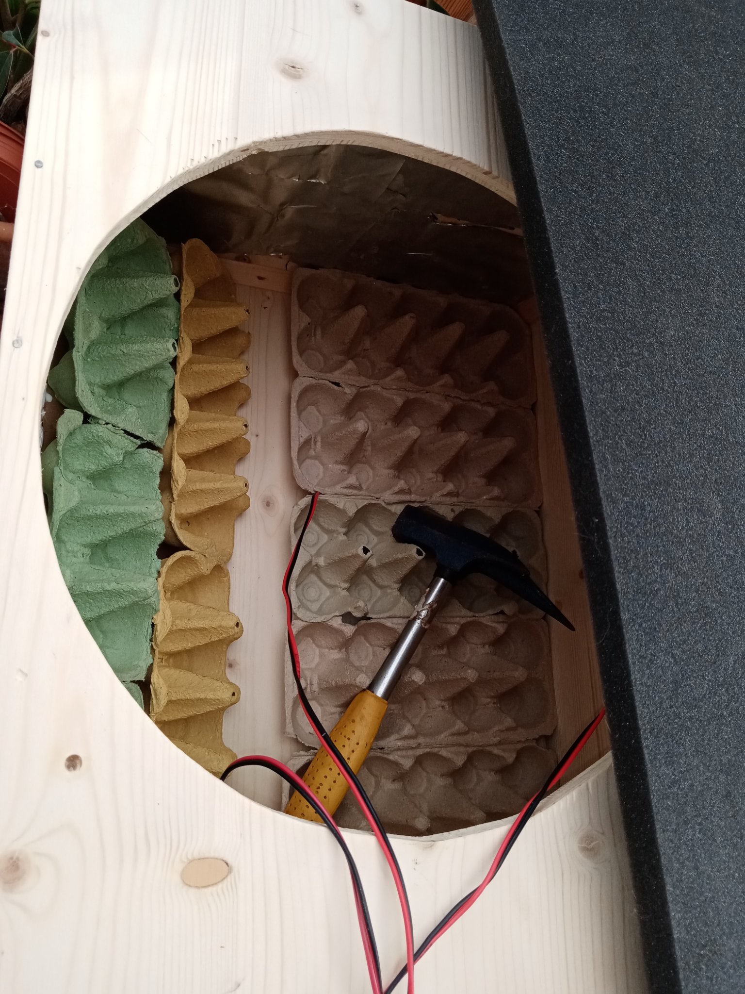

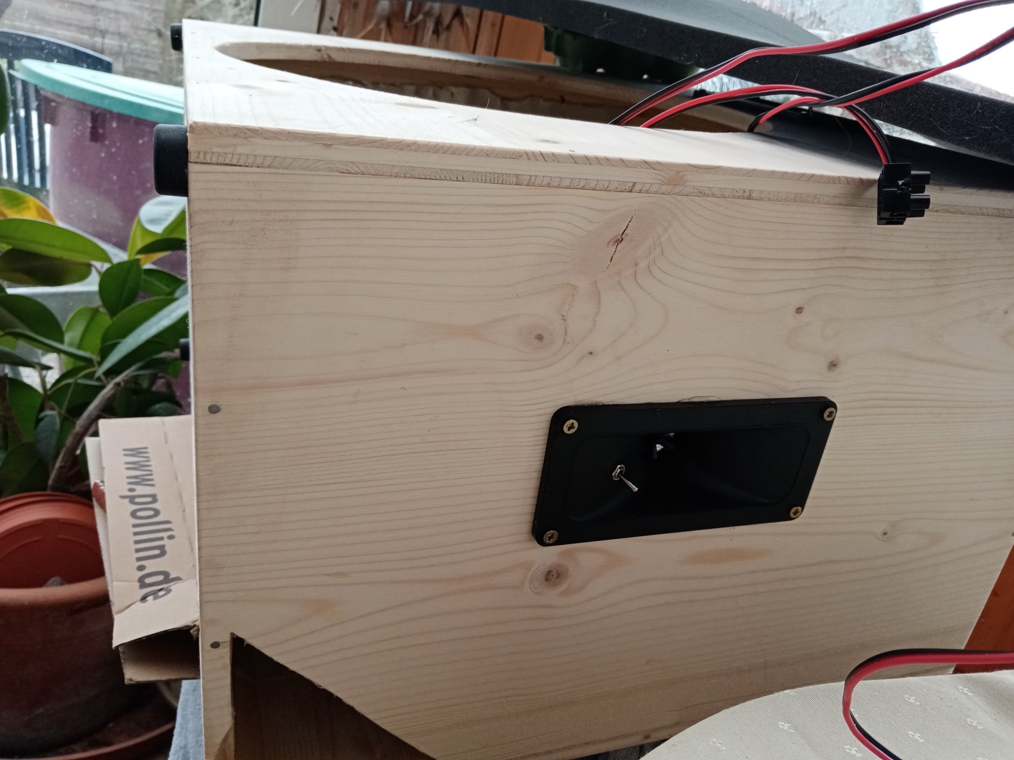

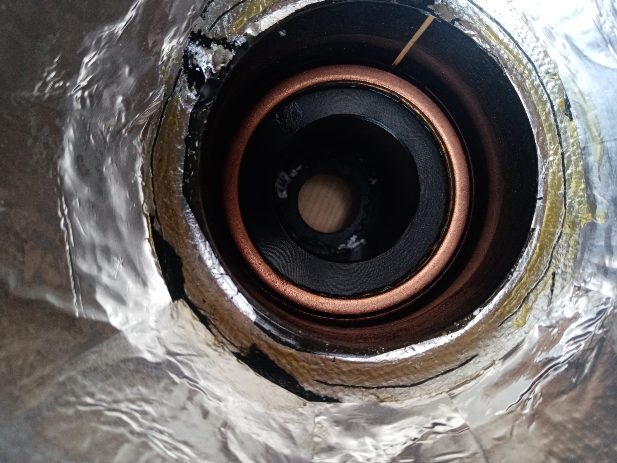

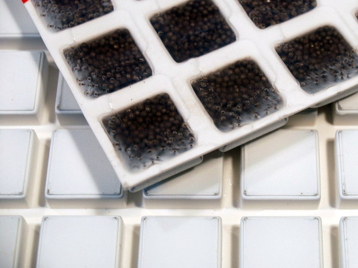

Here some ideas I realized:
glued in egg crates (the real ones) and using a thin sheet of damping. Thats for being localized more in the middle of the box where it is damping lower frequencies than only being positioned on the walls
reflex port in the corner of one wall as a cutout and port made of cardboard sheets glued in. Easy to realize bigger port diameters like this.
piezo tweeter on the side for indirect high frequency dispersion but it can be put on and off to taste
