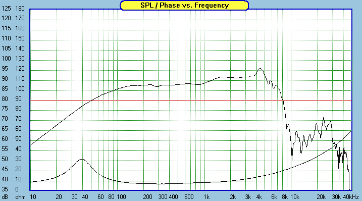

I see some problems in what you are trying to do. The FR of the two drivers are quite different in the (probably) crossover region, the ER18 doesn't roll off until the breakup. The ER18 is also less efficient. I suspect that the crossover won't work as intended with the new drivers, and there isn't enough info on the site on how the crossover is supposed to work (crossover point, transfer function), so even if you have measurement equipment, it would be rather difficult to emulate the Proteus, in fact this would be a new project.
IMHO, I think that padding down the tweeter is not enough, you probably have to modify the response of the mid woofer. The only way I see for doing this is to simulate first the design with the intended drivers, and then with the new drivers and then to modify the crossover until you return to something similar to the first simulation. See the sticky for an how to.
