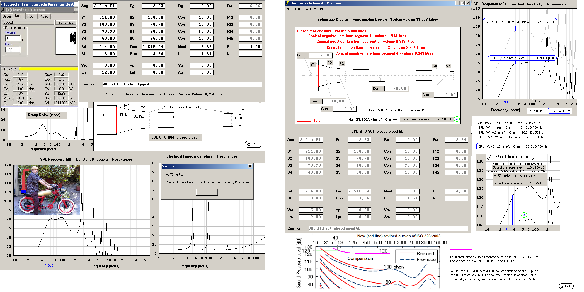

Looking for ways to do exactly the opposite of what my skill set has taught me. I'm used to building big, loud subs with inefficient drivers in sealed enclosures and lots of wattage. I'm considering doing the opposite; inexpensive, efficient driver for modest output. Long story short, I have a motorcycle with two 6.5" coax in the fairing and they do a poor job of reproducing flat. From about 300hz up they are wonderful. I just want to fill in the lower stuff. I don't need to boom boom, just want to get a little more SPL down to a decent cutoff... maybe 60hz?
I might have space for an 8" in one of the hard bags, but I have a feeling one or two 6.5" subs would be a better fit. How do I engineer an enclosure to maximize their potential? I have about 60w RMS to play with, and only stable to 4ohms.
I haven't measured the hard bag, but just eyeballing it I'm guessing a little more than .75 cuft.
No helmet to contend with except on highways... at which point the road noise drowns out everything so who cares. Even so, I wear a brain bucket so my ears are exposed. I'm looking more for the lazy sunday back-road thrashes.
As far as the shape of the bags, this won't be a "build a cube and call it good" thing, I'll have to frame something up out of something flexible like luan and make a fiberglass enclosure. The fabrication part is my strong point. I can build anything, just need to know how to go about building it.
Most of my experience is going with factory suggested volumes... that is to say, the factory says "sealed enclosure 0.8-1.25 cu ft"... so I build a 1.25 cu ft mdf box and EQ it from there. I rarely do ported or bandpass (mostly because I like my trunk to actually have cargo room) and even when I do some kind of porting, I just follow instructions.
And I was exaggerating a bit on the 300hz. The speakers are advertised as 40-22k hz, but they don't list a -3db point. So let's be optimistic and say they are reaching down to 150 effectively, but they drop off pretty quickly... at least what my ear is telling me.
They are Polk dB 652 speakers, in case that helps.

You could go with a simple sealed or ported enclosure, if the driver is of sufficient size, I would look at an 8" or 10". If you mount the driver in the side of the bag, with a grill and some acoustic foam in front, you might actually have some storage space left. Other options are 4th or 6th order band pass for a bit more output in a smaller bandwidth (say 50 - 150 Hz).

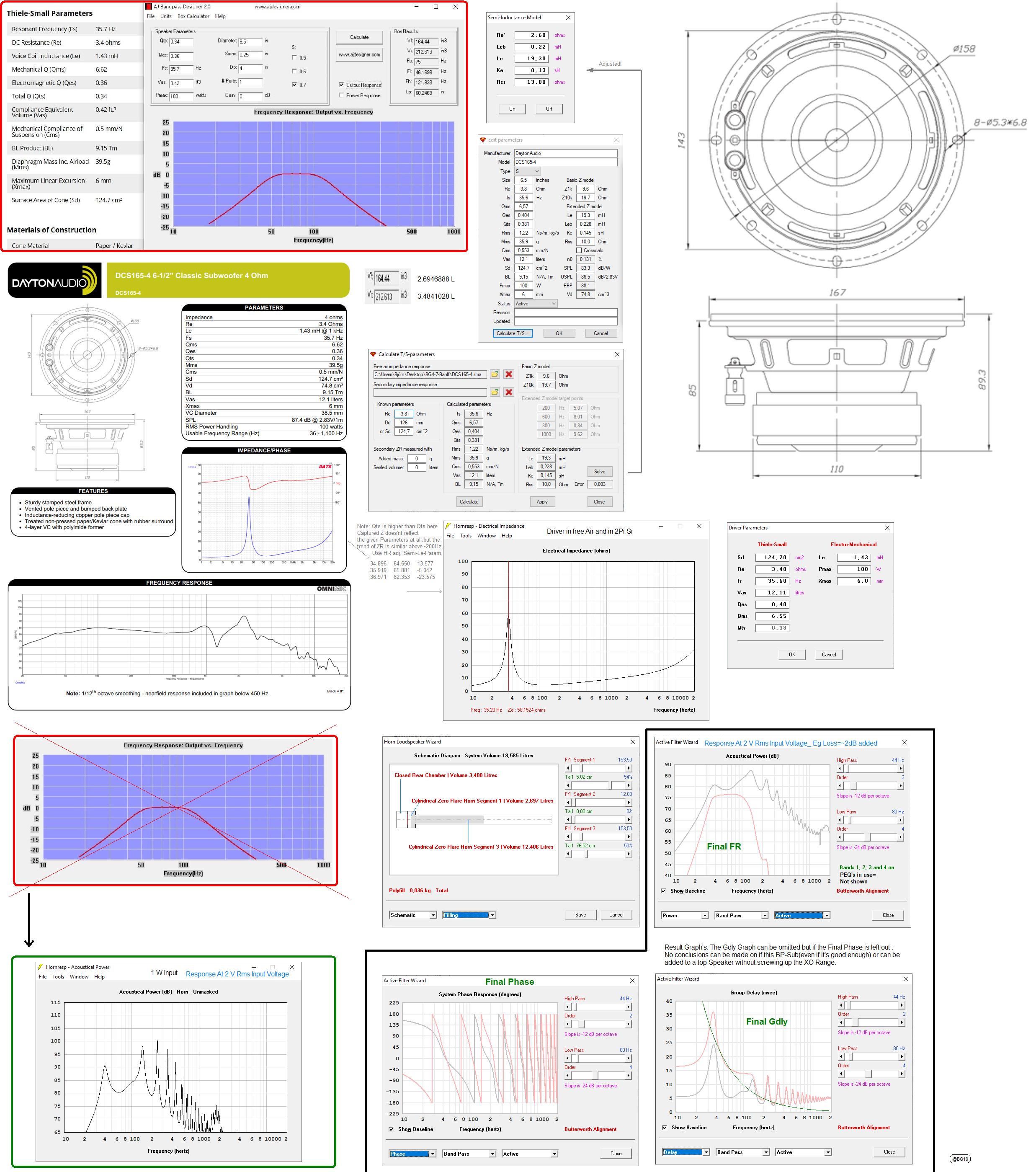

I'm leaning toward bandpass simply for the SPL it can do with lower wattages. Just not sure I can get enough volume with an 8", and not sure one or two 6.5" will really do much.
I was playing with a calculator. Does this seem right to you? 0.09cuft front and 0.123cuft in the back? Seems awfully small. The driver here is a Dayton 6.5" sub.

It looks decent and might be enough. One thing: The port has a 4" diameter and is 60" long, so your port alone is over half a cuft.
Either increase the chamber size, or decrease the port diameter (or both). A single 2 - 3" port should be enough.

Good to know. I can do a 2" but I was concerned about port noise.... then remembered... this is on a motorcycle. I don't care about port noise.
