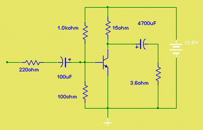

If you wanna something to play with your tip33, here something that may be fine
And will show you how much power you can perceive having only 300 miliwatts.
The 15 ohms resistance is 5 watts..can be replaced by 10 ohms, 12 ohms, 16 ohms or even 18 ohms if you prefer.
It will work hot!...hehe..very hot.
The voltage at colector, measured from colector to emitter, must be adjusted using a trimpot in the place of the 100 ohms resistance you have in the base.... or use fixed resistor, in a try and error basis....measuring to obtain around 7 volts at the colector.
Supply must be good, as circuit will have big power consumption...a class A single transistor operating...the TIP33 will need a 3 by 3 inches aluminium heatsink, and the supply must be huge to accept 500 miliamps of drains without produce too much mains noise..too much ripple.... include a lot of condensers into your supply to increase the filtering.
Having good supply, your noise will be almost nothing and sonics will be fine....more than fine.
The output can be a speaker...a soft speaker...easy to move the diafragm or can be a headphone, as power is small.
The circuit will reproduce from 20 hertz to 20 kilohertz, will accept many different souces at the input (700 milivolts) and will be a good toy.

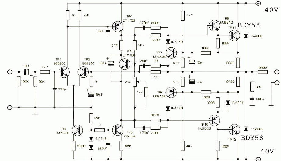

I was reading your personal data, you like tubes, electronic tubes i think...but
those transistors, different from tubes, need a lot of circuitry to make them usefull...they are adequated to output.
Having that good quantity of nice output transistors, you may have conditions to construct a big power amplifier...but a lot of more parts will be needed.
Those ones, alone, do not make a good work.
A Quasi complementary schematic may fit your needs.
here, you have one example about that Quasi....means that use the same transistor up and down....in the output, and normally people use NPN alike the ones your have.
Quasi may have some Latin root...as Quase (almost) is a portuguese name (and all Latin roots language, as Italian, French and Spanish).... Quasi complementary means almost complementary...near the complementary...the drivers are complementary, but the output is not...some arrangement is made to use two NPN transistor.
Naim schematic is attached to you, this one, for instance, with 6 transistors in the output, each one with a protective low value resistance, and using a 50 volts symetrical supply, may produce easy 200 RMS each channel.small modifications will be needed to increase supply voltage...one example only.

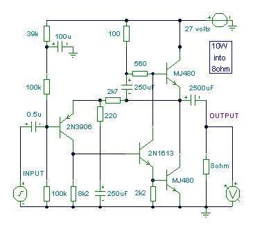

Your TIP33's should sound almost the same as MJ480. TIP33 has fT 3 MHz min, MJ480 had ft 4 MHz (min).
Both better than old 2N3055
JLH69 is certainly a simple good amp. and many people like its sound.
