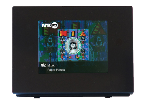

Hi got this device and thought it might be of use to describe it here. I have already modded some things and will be building a linear PSU for it. Tiny M7+ is a FM/DAB+ tuner with RDS, Internet radio, Spotify player and DLNA audio streamer. It is distributed by a Norwegian company called Pinell. It does many things and it may be not high end but it is a very practical device and I found that I am using it every day. I had some issues though which I will describe. Maybe some of you also have the Tiny M7+ and have some benefit of the small mods I did.

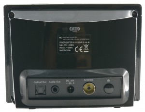

It is very small, 130 x 42 x 95 mm and it's a jack of all trades (but not a master of none 😉). The display is a color LCD with good visibility. It has analog outputs via the dreadful 3.5 mm plug and a Toslink connector for digital output. Yes, analog FM radio is digitised by an ADC and it is the least performing of all features in sound quality. Antenna connector is a coax type and not the more standard F connector. It plays MP3, FLAC, WAV and WMA. I haven't tried high res files yet is what I am typing now and at the same time I ask myself why I haven't bothered 🙂 . Analog output is OK but it really shines when connected to a separate DAC or FDA. It has an IR remote control but since it has wireless 802.11b/g/n connectivty it can be also controlled and "woken up" from standby by the Undok or Pinell app. Nice ! Quite rare is the menu item that firmware can be updated online. For me this is the first of the DAB+ tuners I have tried that has this function. When not used and in standby it changes to an elegant clock.

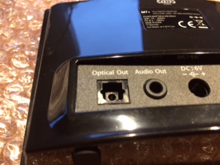

My sample has the phenomenon that the Toslink connector is mounted too deep and Toslink connectors don't "lock" enough to make them stay. Some slight force and they fall out. I am working on a solution for that.

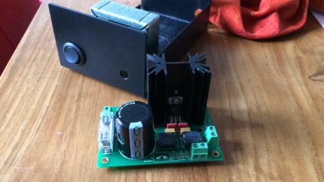

The linear PSU is the one I made for SB Touch devices but set for 6V. The original micro sized wall wart is a 6V 500 mA type. Since my PSU is a linear PSU with a 6V 12VA transformer I can not make it smaller than this. The LDO regulator chip can deliver 3A but this transformer limits this to 2A. In 6V chassis mount transformers there is not much choice and I ended up with an EI type despite having very nice 6V Rcore transformers (don't fit in the chosen case). The transformer has been treated with slow curing potting compound to make it mechanically silent. This can be done as load will be way less than it can power so no heat problems are expected. It can be switched off from mains but the M7+ is meant to be powered on continuously. We'll see what works out best.

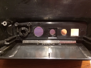

The tilting is solved by glueing some nickel plated brass standoffs in the lower part of the back cover with 2 component glue. The standoffs fit exactly in height and in width. The device now does not fall on its front when one touches the cables but it flips back on its feet again.

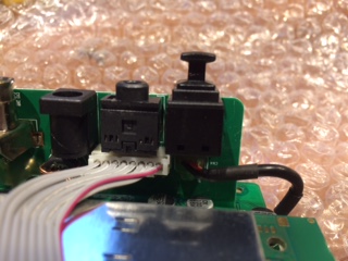

A Toslink plug of an optical cable to a DAC or FDA looses its "lock" because the wrong type of Toslink connector is used in the M7+. A type with screw hole for mounting against a back cover is used but in this device no screw is used. The (unbranded) Toslink transmitter with screw hole is a bit deeper than the type without screw hole. Using the screw hole type causes the transmitter not to be flush with the back cover. This is why Toslink plugs that are inserted don't lock as they should.
I replaced the unbranded 3.3V Toslink transmitter for an Everlight PLT131 and that one is nearly 1 mm longer. This is a Toslink transmitter without screw hole and without shutter as I don't like the shutter type. Now the connector is flush with the back cover and Toslink cables are locked fine.

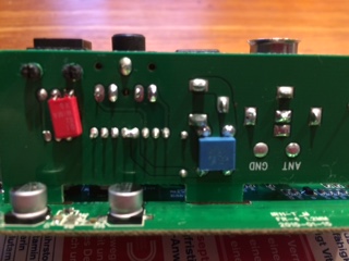

Meanwhile I have changed the coax connector for an F connector and use a linear PSU with better results than the original SMPS.
