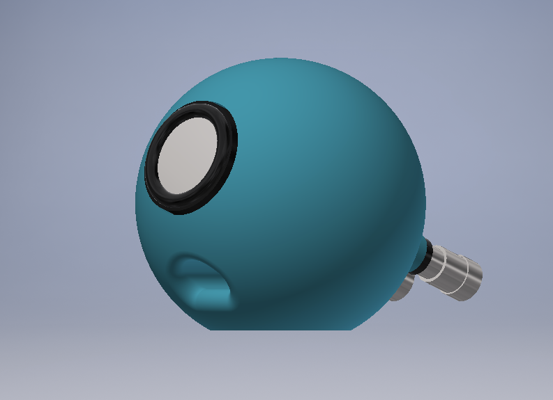

As it stands, everything assembled will look something like this. (Cyclops?? Maybe I'll paint them yellow and call them The Minions
And the cutaway internal view:
I haven't been able to find many tiny ported speaker builds like this, so I would love some feedback. I'm not even completely confident I've done the calculations correctly! Particularly interested to hear what people think of the volume and whether I should be filling with some amount of damping. Could texturing the internal walls have any beneficial effect?

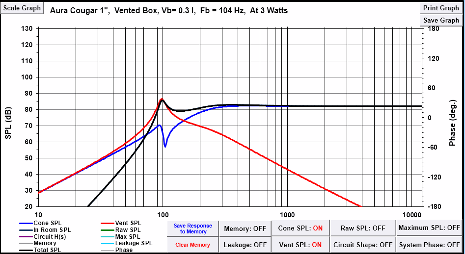

Did a little more playing with Jef Bagby's calculator today, and spent a couple hours playing with a new enclosure design in Inventor.
Discovered that Jeff's calculator does in fact show xmax information. It too was showing way over xmax for the Tang Band at 100 Hz / 1W.
Messed with calculations for a couple of the larger (if you can call 2" larger 🙄 ) drivers, and to me it looks like for a decent f3 of 100 Hz or so they want much larger enclosures than I'm willing to give them, sealed or ported. Maybe I'm doing something wrong... but for now decided to spend some more time with the Aura Cougar. Discovered that the xmax is no longer a problem but the 1/4" diameter port was wayyy too small. Port velocity was literally off the charts. So I squeezed a few more mL of volume from the enclosure and increased the port to (equivalent to) 1/2" diameter. This results in a peak port velocity of 40 m/s which I *guess* is okaaaay? I hesitate to go any larger.
Enclosure volume now sits at roughly 0.26 L, with a 5.0" long port. Going to have to wait for drivers and wire terminals to come in the mail to get it exact, as it seems like at this scale every mL makes a difference. Or I'm just thinking about it too hard
Anyway, here are a few pics with the new enclosure arrangement and some calculation results. I think I'll go ahead and order these drivers and see what happens.

On a scale like this, as you note, every cc counts.
FWIW I have experimented with slightly larger drivers, at 2", primarily tangband W2 800SL, but also Visaton FRS5X.
This tangband has Fs of 160Hz or so, and low Qts, and thus for a mid tweeter application, in a sealed volume, I calculated something like 55cc internal volume.
Due to the low Qts and highish Fs, these wont do bass, but the principle is the same.
I ran the drivers in small cuboid tealight holders, that were the correct volume, plus a few cc for the driver chassis displacement.
WinISD is a free program that will allow you to simulate both sealed and vented designs, once you've inputed your driver TS parameters.
You'll see in WinISD that the higher Qts of the Tangband 1" will pull the F3 point down a little below Fs in a vented cab, but it will be very finicky about vent length and cab volume, as well as driver tolerances.
E.g. if Qts is higher than spec sheet (usually the case IME) then volume and or vent length will become more difficult to accommodate inside the cabinet. This can be designed for, of course, but with a Qts approaching 0.7, then things reach a point where although bass output is increased, it may be lumpy, peaked, and hungover with larger group delay at LF

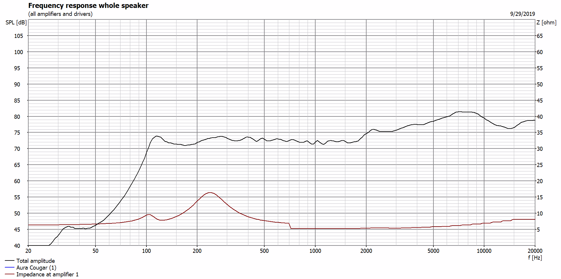

In the meantime I took your advice and imported the Aura Cougar driver to boxsim using SPLTrace. If I'm understanding it correctly, I'm somewhat encouraged by the results. High frequencies will definitely need to be rolled back (probably with EQ) but other than that it looks ok. Correct me if I'm misinterpreting somehow. This is at an internal volume of about 0.28 L, with a port tuned at 115 Hz.
Well efficiency isnt great, bit you expected that.
The 10dB or so hump from 2k to 10k isnt so good, but could be dialled back with shelving EQ - that would probably leave the last octave attenuated somewhat.
Can I ask, are you sure your "cabinet" dimensions entered correctly into Boxsim?
I assume, that you used a similar sized driver loaded into Boxsim, and then imported frd and zma files? Cant see any Baffle Step at all (that is unless the Baffle step IS the rise from 2k onward)

I had to somewhat fudge the dimensions of the cabinet since there's no option for a sphere. This is a baffle of 3 cm x 3 cm (and the diameter of the driver is about 2.6 cm so pretty close)
I used the SPLtrace software to create frd and zma files from the manufacturer datasheet of the Cougar driver, then imported those files to boxsim. Took a little bit of figuring out but I think it's set up correctly now. I assumed that the rise above 2k was indeed the baffle step effect, since I learned that a spherical enclosure should show a smooth increase of 6 db from low to high frequency, which this seems to show, but there is a small bump above 2k on the datasheet for the driver as well.
I agree the SPL even at listening range leaves something to be desired. I adjusted the listening distance to 70 cm from 100 cm (splitting hairs here but it is more accurate) and it helped a bit (inverse square law in action I suppose). I'm hoping that placement and positioning near the wall might help a bit with that, which I don't think I'm able to simulate. I guess I could see what boxsim comes up with when I give the cabinet a very large baffle instead... Might give me a decent ballpark. Maybe I'll try that.
