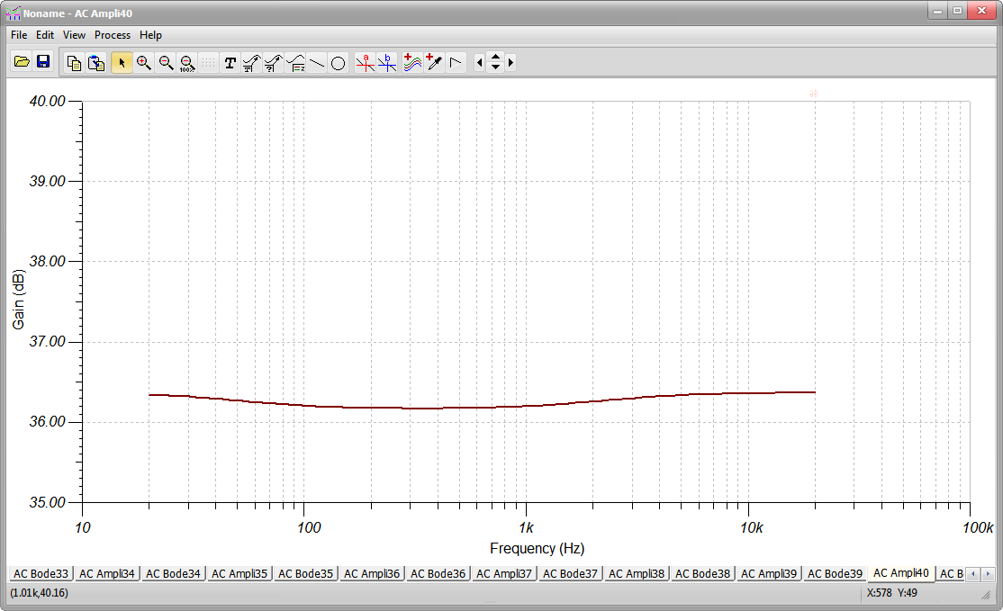

I already have the phono stage but need lower gain. I am trying to simulate 5751's in the 12AX7 location to see how I need to change my RIAA components due to the different tube characteristics.
build-out resistor should be ~10x the value of rp (as rp will changes over time). for a tube with high rp (58k for the 5751) a 580k resistor will bring with it ~100nV/RtHz noise.
from the value of buildout resistor (r1 in lipshitz transform), r2=6.88 x r1, c1=318uSec/r2, c2=c1/2.92

Questions:
1. Can I just reduce the series resistor coming off the plate to simulate the reduced Rp?
2. Am I correct in my mu assumption in the formula?

5751 TINA Spice Model
Code:
* Generic triode model: 5751_AN
* Copyright 2003--2008 by Ayumi Nakabayashi, All rights reserved.
* Version 3.10, Generated on Sun Dec 17 16:41:13 2017
* Anode
* | Grid
* | | Cathode
.SUBCKT 5751_AN A G K
.PARAM X1=-0.044770209 X2=0.032175849 X3=-2.2476294
.PARAM X4=0.40025303 X5=18.639663 X6=3.7476294
.PARAM X7=0.0040093865 X8=46.569699 X9=0.0099503146
.PARAM Y1=0.0020046932 Y2=0.0021345255
BK IK 0 V=U(V(G,K)+X1)*X7*URAMP(V(G,K)+X1+URAMP(V(A,K))/X8)^1.5+(1-U(V(G,K)+X1))*X9*(X2*URAMP(V(A,K)))^X3*(X4*URAMP(V(G,K)+X1+URAMP(V(A,K))/X5))^X6
BA A K I=URAMP((Y2*URAMP(V(A,K))^1.5)-URAMP((Y2*URAMP(V(A,K))^1.5)-V(IK)+Y1*URAMP(V(G,K))^1.5*(URAMP(V(G,K))/(URAMP(V(A,K))+URAMP(V(G,K)))*1.2+.4)))+1E-10*V(A,K)
BG G K I=Y1*URAMP(V(G,K))^1.5*(URAMP(V(G,K))/(URAMP(V(A,K))+URAMP(V(G,K)))*1.2+.4)
* CAPS
CGA G A 1.4p
CGK G K 1.4p
CAK A K 0.5p
.ENDS
