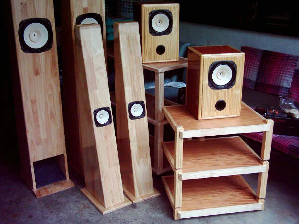

Thanks Bernard. I'm happy you had a good time, I wish I could have been there. Along with my speakers in this picture are other Fostex projects built by "Handyman". He's a skilled workworker. I know most attendees of the Audio Fair are not familiar with DIY speakers so I wanted to show something that was easy to build, inexpensive and sounds great. From what I've been told I think it was a success. 🙂
I updated the web page containing the details for the "FQ127".

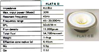

Thanks for the help offered!
nominal size
6.5"
impedance
8 ohms
Fs
45hz
Qo
0.52
Diameter
8"
depth
2 9/10"
i really appreciate the help! thanks!
nominal size
6.5"
impedance
8 ohms
Fs
45hz
Qo
0.52
Diameter
8"
depth
2 9/10"
sorry, i`ve got no more data. its a vintage coral flat 6 driver. the above data was all i could pull out.
I suggest starting a new thread on this forum and asking if anyone has the specifications for this driver or experience working with it. That's just not enough information to do accurate modeling. Sorry.
hacknet said:what other information do you need? i`ll continue digging..
Vas
BL
Qes and Qms would be nice too. Try asking over at Full Range Driver.
