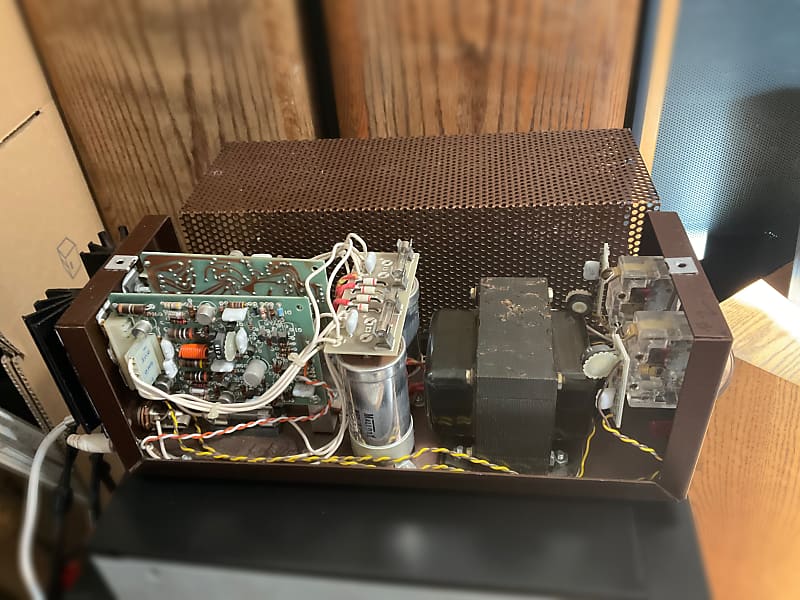

Thanks for the replies, I had found some of these - every 215 query I made got back to the 01 or "Universal" article. The video was great and it showed the main differences between the 215 amp and the 01 amp.
1 - the 215 used 220 "plastic" outputs instead of the T03's since it was rated for 1/2 the power of the 01. They appear to connect via an edge connector directly to the board.
2 - the main circuit board, while using the same circuit as the 01, appears to be different. Especially the driver transistors which are not the 40409/40410 pair with integral heatsinks.
3 - the connections to the boards are different using two "molex" type, one for the power/ground connection and another looks like the output transistors connect.
See the attached photo - the board really looks different
It would just be easier to have the schematic and board layout to check the unit out but I can't find anything but the Catalog page for the 215 Stereo amp.
Michael
