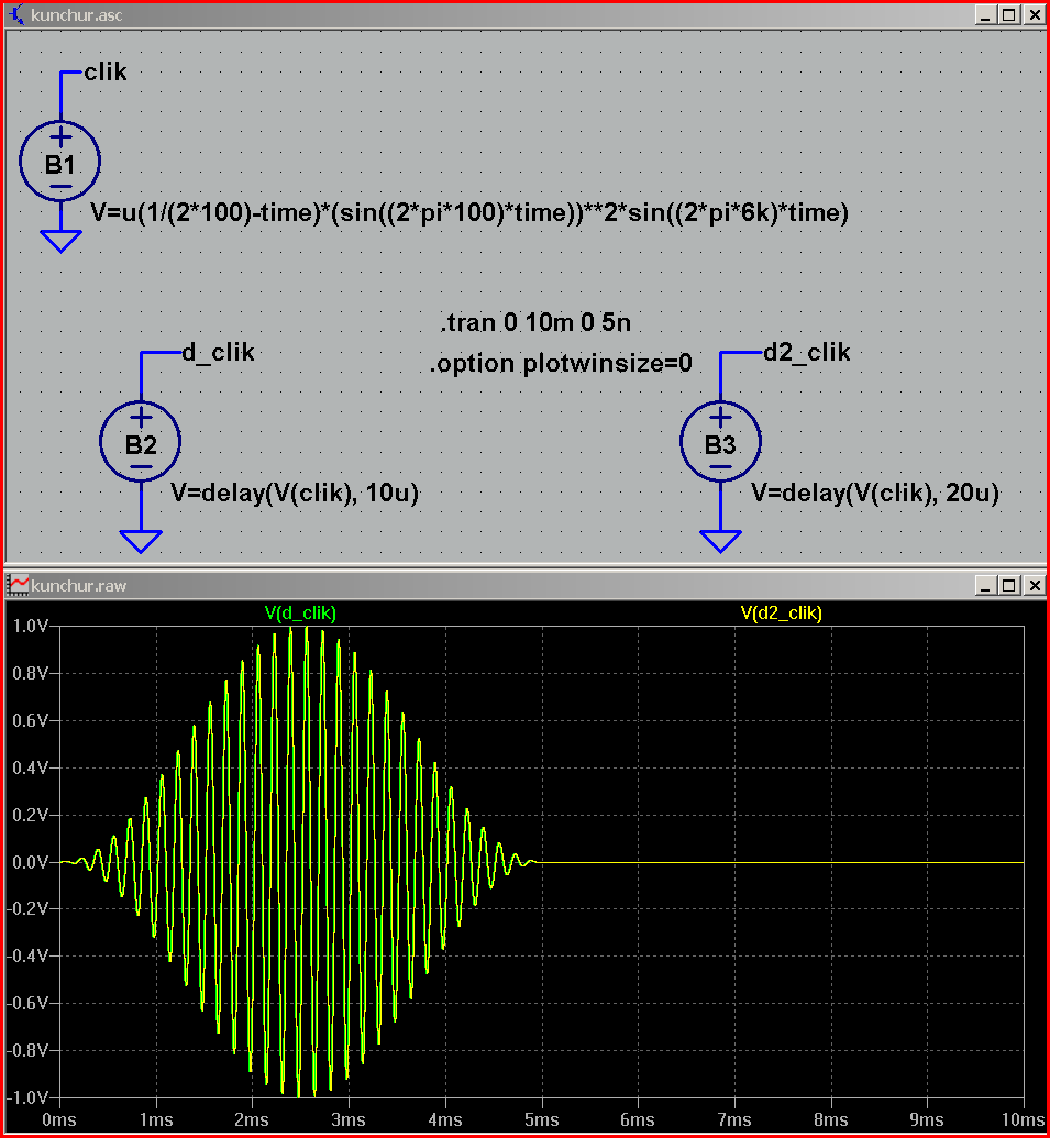

the Fourier domain is fine too – the “amplitude only” restriction is a strawman tactic for use in Sophmoric arguments
“The Fourier Transform” of a time series contains both amplitude and phase info – using single complex number values for each frequency bin
the intra aural uS time domain resolution results say nothing about hearing beyond 20 kHz
the test signals are all “in band” - enveloped sine bursts of << 20 kHz
the sim below show the spectrum of such a burst signal, its frequency content falls over 100 dB by 20 kHz – practically no “information” is conveyed above 20 kHz
I delayed the raised sine enveloped 6 kHz by 10 us – you can read the delay from the fft plot cursors (both @ 6 kHz) calculate it yourself from the 6 kHz, 21.6 degree phase difference
no "100 kHz" info used in the calculation - no evidence any gets to our our brain via our ears
