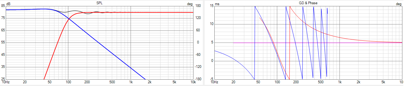

So in theory a fourth order reflex speaker with a third order high pass filter, with 2nd on the woofer compensates 8ms at 100Hz. In practice it won't be as simple, naturally.
Allen, do you know if an allpass could induce 8ms delay? It would need a number of cells in series to achieve such a high value from my understanding.

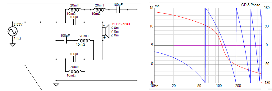

Sure, anything could be done.Allen, do you know if an allpass could induce 8ms delay?
I'd put a lot of effort into optimising one, not like I've done here just for simple proof of concept. I've made phase within +/-90 degrees of 8ms for two octaves at 100Hz.

I did not say it is a good or easy solution for your situation. Just that it is possible to do so, and that you don't really need a dsp or electronics to do it.
Worthy of experimentation maybe if you like to do so.
