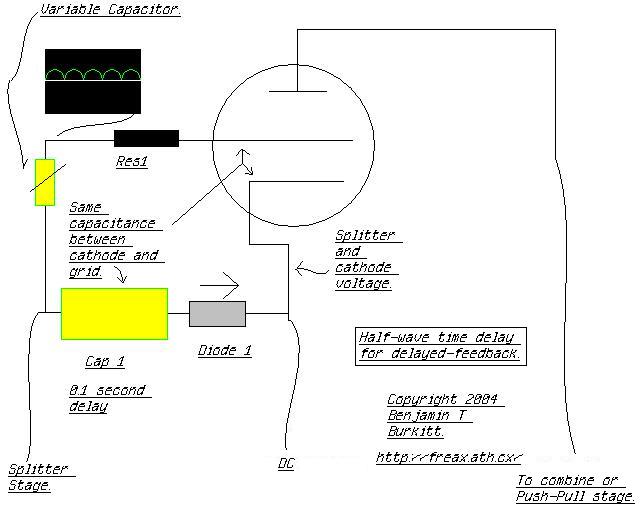

Step 1: Half-wave comes from Splitter stage at plate voltage of that stage and is placed to the proper grid voltage by Res 1.
Step 2: At the same time the capacitor is showing a signal on the cathode, which is also the same wave, but is very faint.
Step 3: The grid acts as a feedback to the cathode /internally/
and externally.
Step 4: When the plate is saturated by the cathode and grid is not supressing electrons, This time at which it is acting as a Tetrode, when the grid is supressing electrons it acts as a feedback path to cathode and the plate is as if it wasn't even there.
Step 5: the variable capacitor acts as a fine tune to the time at which it takes for the signal to pass back to the cathode and re-create the loop, essentially cancelling out a small amount of it's own signal.
I think that's about it, tell me what you think...
I think the only way I can describe it is that it is a threshold diode which turns into a Tetrode while the screen is energized.
Maybe this will supress noise, maybe it'll fry.
I have apsoloutley no idea how it would work nor made calculations or simulated it.

I'm losing you at your premise.
Here is an idea for those who don't like the fact that normal error correction or negative feedback always ends up correcting the error after the fact. Thus creating higher harmonics, as the error in the error signal propagates endlessly around the loop.
I'm not an engineer, but in the derivations of basic feedback equations I've seen, the delay is assumed to be negligible. The conversion of high levels of low order harmonics to low levels of high order harmonics is a consequence of the feedback itself, and this conversion is independent of any delay and independent of the frequency. Now where delay DOES enter into things as a practical matter is in loop stability at very high frequencies, but that's not really relevant to the question of production of higher harmonics in the audio band. Even with zero delay, you'll still have those higher order harmonics.
/me looks stunned at SY as usual 😕
WHAAAAAA!!!!!???
All hail Holy and Wise SY! 😀
I'm going to leave the whole thing as it is, TOO much for me!, glad however that I came up with "feedforward" in a matter of 2-3 hours...I bet any Phillips employee would have been proud to have me 🙂🙄
