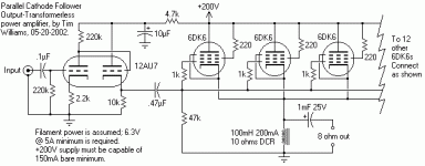

Hi!
Is it possible to modificate the original Parallel Cathode Follower 6DK6 OTL amp to use 6C33C tube?
Greets:
Tyimo

There is not much one can do wrong in such a CF design.
- provide enough clean gain. The 6C33C will have a gain of about 1/2 in CF, so for 1W in 8ohms (2,83VRMS), the driver will have to provide at least 2x2.83VRMS, say 6VRMS.
- provide enough current in the output stage. Pure class A, so the 200mA (based on the choke figure) of standing current can only swing between 0 and 400mA. Output power with 200mA is about 8ohm * 0.2 * 0.2 = 320mW. So, more 6C33Cs and a bigger choke!
So it is only usable for headphones and high Ohmic speakers.
