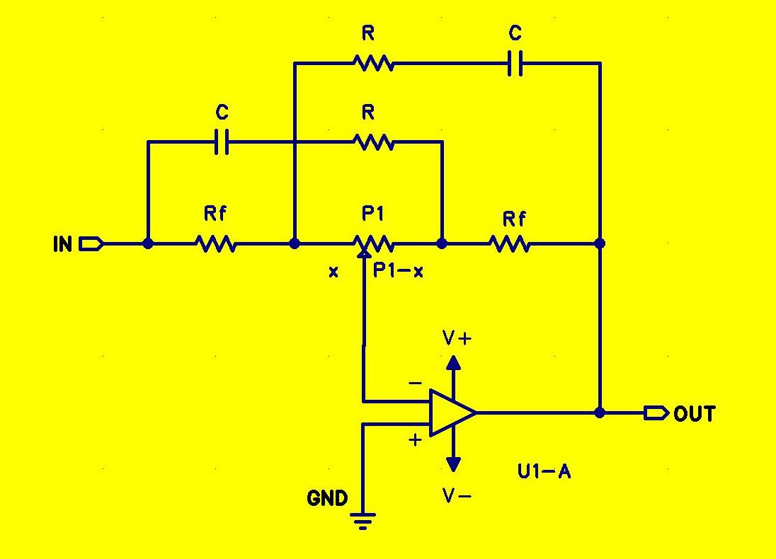

This filter was introduced in the early 1970s by Quad Ltd in their model 34 preamplifier. A single knob allows you to tilt frequency response around a pivot frequency (Fp), [FONT=Verdana,Tahoma,Arial,Helvetica,Sans-Serif][FONT=Verdana,Tahoma,Arial,Helvetica,Sans-serif]by simultaneously boosting the treble and cutting the bass frequencies or vice-versa. See Heawwize site:http://headwize.com/?page_id=741
Up to now the filter was tuned by means of PSpice simulations.
In my EDN article:
[/FONT][/FONT]
http://www.edn.com/article/520749-Implement_an_audio_frequency_tilt_equalizer_filter.ph
I derived the transfer function and the formulas to calculate the components value following the desired
Fp (pivot frequency), the Boost/ Attenuation at Low frequencies and High frequencies.
Next time I will give you some examples.
If somebody will a particular Tilt equalizer, I can calculate the components.

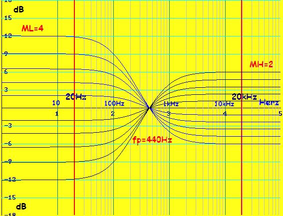

CHANGING Fp pivot-frequency. Dear SmartAlex,
If we see the parametric equations in my EDN publication there is a good news and a bad one.
Good: the pivot frequency Fp can be changed without changing ML and MH (asymptotic low/hi freq boost-attenuation)
Bad: you must change the couple of capacitors C (fig.1) to change Fp. With other 2 capacitors in parallel to C (with a switch) allows to have Fp = 440 Hz, 1kHz, 3kHz.
If you give me your specifications: ML, MH, Fp1, Fp2, Fp3 etc.. ,I will caculate the componentsfor you. FB

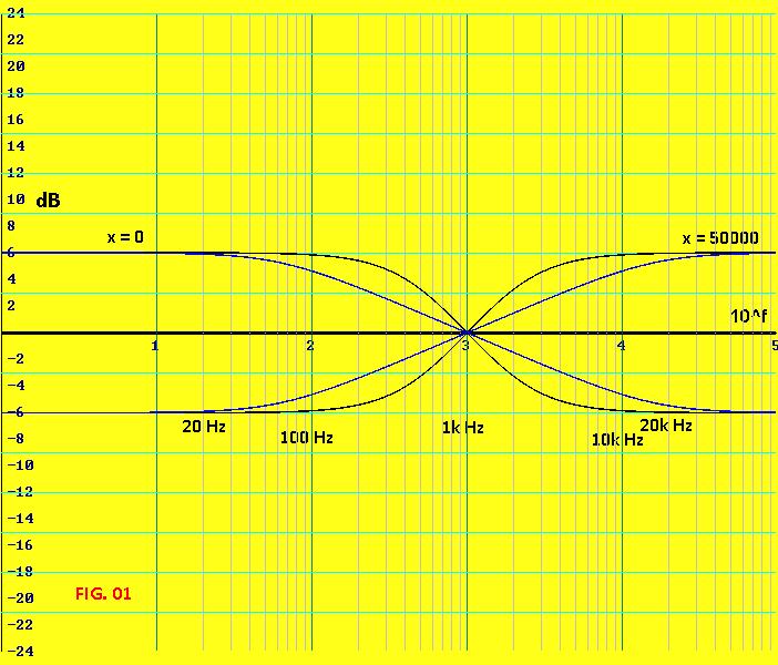

In the article, it shows a response that varies between about 100Hz and 10k Hz, but below 100Hz and above 10k Hz the response has flattened out. Can these limits be changed, and how? Is it possible to make the frequency region where the tilt is occurring wider?

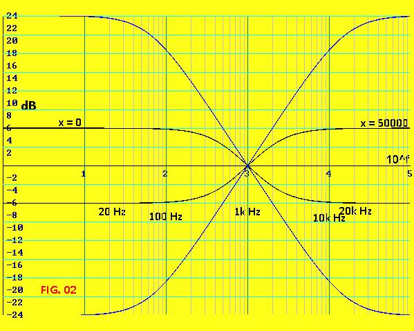

Is FIG. 01 what you ask for? Figure depicts the responses at wiper position x = 0 Ohm and x = 50 kOhm. The blue curves have a wider tilt zone (F-3dB shifts toward 20 Hz and 20 kHz). Unfortunately ( at my knowlege ) the only way to widening the tilt zone is to enhance ML and MH (the max asymptotic boost/attenuation at at low and hi freq. , that happens for the extreme wiper positions of P1, i.e. x=0 Ohm , x= 50k OHM). See FIG. 02. So it is possible but ML and MH are very high:24 dB. The boost/attenuation jumps from 6 dB to 24 dB.
6 dB: the signal is enhanced (atten.) 2 times;
24 dB: the signal is enhanced (atten.) 16 times!
FIG. 01 : the blue curves are artifacts; the black one have:
P1= 50 kOHM, fp= 1kHz, ML=2, MH=2, Rf=50 kOHM, R= (50/3) kOhm, 4.77nF.
FIG. 02 : blue curves: P1= 50 kOHM, fp= 1kHz, ML=16, MH=16, Rf=(10/3) kOhm, R=(10/51) kOhm, C=50 nF.
Comments? Bye Francesco

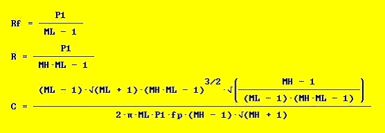

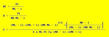

Friends ask me the set of formulas to "tune" the Tilt Equalizer Filter, because in my EDN article the editing is not clear.
Use the ref circuit
for the components names.
First you must choice the Potenziometer value P1 ( example: 50 kOhm).
Then you must decide the pivot frequency Fp (it's the frequency at wich there is no change, intersection of all the responces).
Then you must decide the Boost/Attenuation at low freq: ML and the Boost/Att at hi freq: MH.
ML and MH are NOT in dB, they are amplification factors (ex. ML= 2 ---> 6dB; MH=1.413---> 3dB and so one...).
Then you can use R, Rf, C formulas
Let me know if it's clear. Francesco

In my previous post (how to tune the Tilt Filter) at the end there is the Fp formula: you don't need it. Francesco

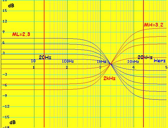

Can the attenuation above and below the tilt be specified?
ML the max boost/attenuation at low freq
and
MH the max boost/attenuation at hi freq
it's possible to have 3 situation (your choise):
ML=MH, ML>MH and ML < MH see attached FIGs
Notice that the pivot frequncy (tilt frequency) can be different (eg. 1kHz, 440Hz, 2kHz)
If the question is to have a Boost different from Attenuation (eg. MLboost= 5, MLatt.=3 ; MHboost=2, MHatt.=6) the answere is:
with the reference circuit
I'm working about that. The parametrization is far more complicated. When I finish the job I pubblish that. Francesco
