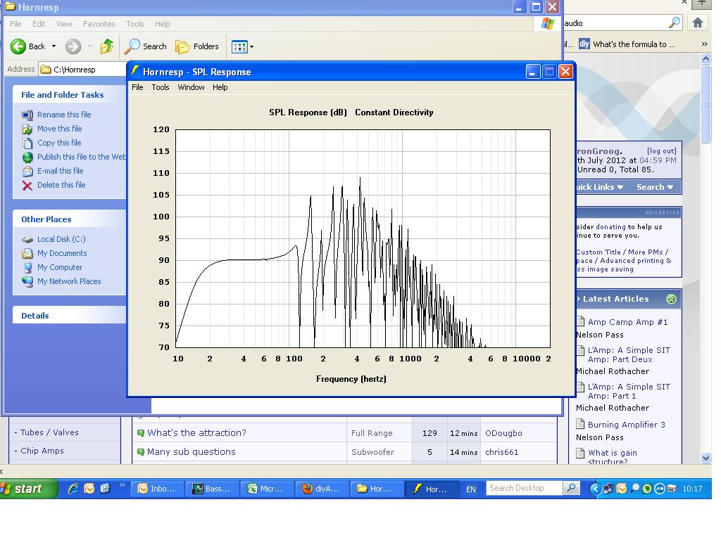

Images below are my B139's predicted response. EDIT wrong RTA, deleted while I find the right one!
So, if anyone other than BuildMeSomething and Sreten have anything useful to contribute please do🙂

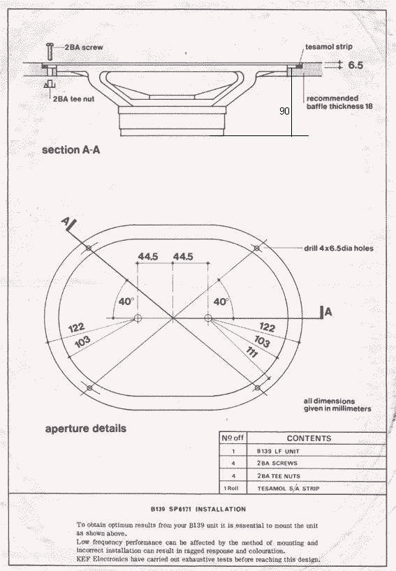

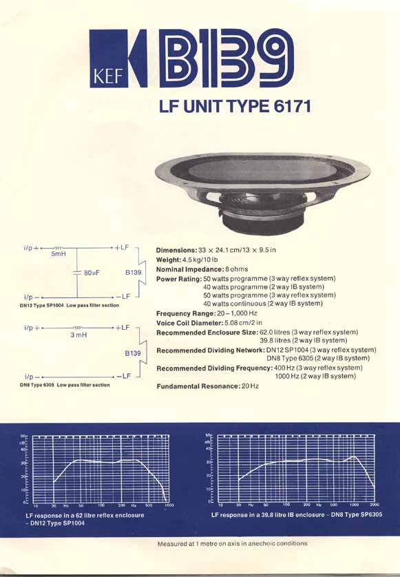

The B139 is typically rated at 50 watt, it has a limited excursion therefor it would not shake the walls. However, it can go low - very low and in an isobaric loaded transmission line, it would be flat down to 17 Hz.
Personally I would not use B139 as subs since they are quite capable of frequencies up to 2.5kHz and would rather employ them as the stereo woofers over the range 20 - 250 Hz; use two mid-range and two tweeters of choice.
Of course the B139, B110 and T27 were a good match and set the stage in the 60s, 70s and 80s for what is now known to be high end audio .
Many of us would vouch that the B139 was one of the best woofers ever built.

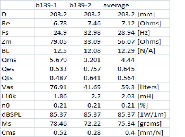

Nico, thanks for the spec sheets-I was just thinking about the cut out last night and whether my calipers will extend far enough to measure, so that's a great help.
I've already pulled my own TS spec off them-alas quality control wasn't what it is now and they are considerabley diffierent in spec-I've played with the two spec in HR and with my proposed enclosure and deemed it acceptable for sub duties, at least until I can find another B139, I wouldn't have thought for a wider range of reproduction they would work too well.

Make sure to 'exercise' the speakers before measuring TS if they have been sitting unused for a long while (some will show problems even after a few weeks). The best way would be to drive them free air with LF noise (ad that includes some subsonic content) at low power (not to exceed excursion) for a while - and some do need a good 3-4 days. The same applies to new out-of-the-box speakers. Without doing this it can be rather amazing how much they can deviate from factory spec. A simpler alternative is a small wall-wart transformer with an AC output, a few V will already do the trick, but this might take longer if the speakers resonance is far from 50Hz. This of course applies to larger cone units.
Also regarding your project in general, you will have to deal with edge diffraction issues on tweeters as well as baffle step compensation, two issues which rarely come up in car system design... A further thing to consider in a multi-way speaker with large excursion units operating below 300Hz or less, if you have two, you might consider mounting them on the sides in a distortion cancelling push-pull arrangement. This makes them operate mechanically in counter-phase so vibrations transmitted to the cabinet cancel out, while they still operate in phase acoustically.
