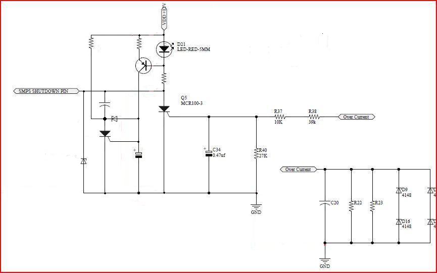

Hello
Thanks for replaying.
Check attached schematic of the circuit.
Its very simple, once the over current reaches the specified thershold, it will trigger the thyristor, so the SMPS will shut down, the only way to bring it back online, is to disconnect it from the mains supply for a few seconds.
There, I need a circuit or modification so I can make it AUTO recover after 3 seconds for example. without disconnecting it from the mains supply.
Regards

Hello
Regards

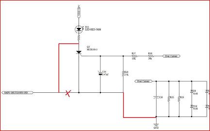

Probably some errors in your drawing ?
And and idea how to solve the restart problem.No values given, depents on the rest of the circuit and properties.

Normaly the shutdown is active when pulled to ground.With shutdown on the + that starts the supply.
Also to ignite the thyristor it needs a positive pulse on it's gate in respect to the cathode.But with the cathode floating somewhere ?? And an chemical between gate and cathode a pulse will pull the cathode up too.
