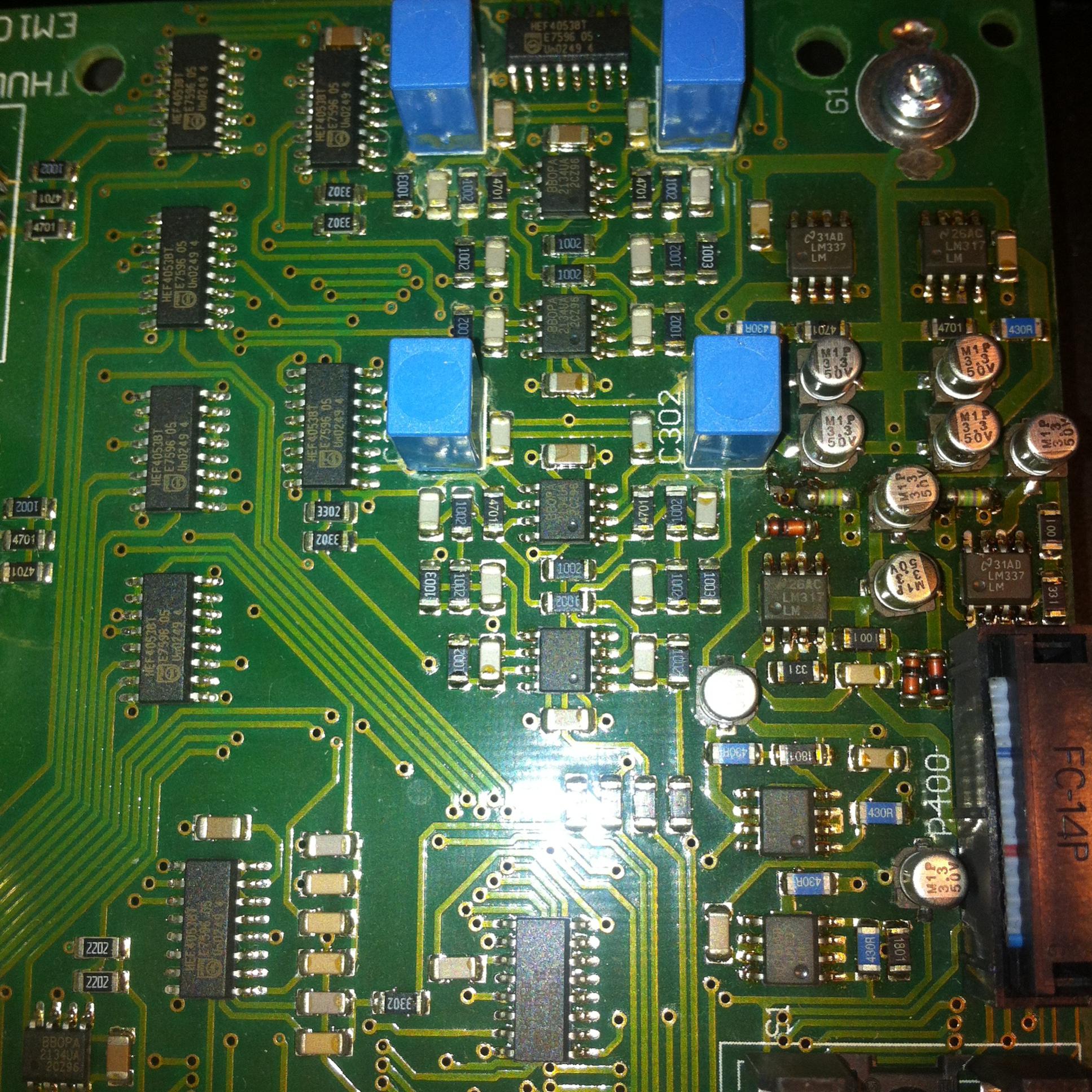

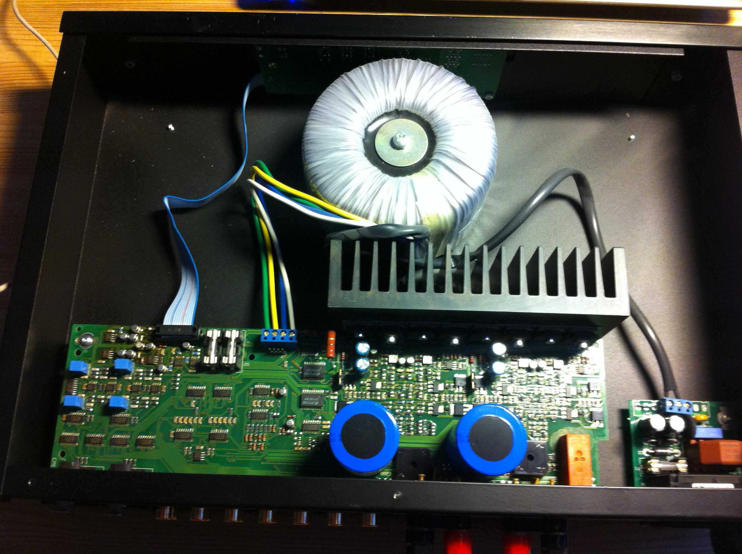

For decent-quality electrolytics in casual home use, 14 years is nothing. And I doubt a manufacturer willing to use a multilayer PCB would skimp on parts quality there. What sort of brands/series did they use? Trying to fix things that aren't broken tends to be a fabulous way of creating some real problems.
OPA2134s are good opamps when used properly, which would have to be verified. (On a quick glance, I can't make much sense of the opamp circuitry shown.) If you can't find schematics and don't feel like shelling out for a service manual, you'll have to reverse-engineer the circuitry yourself, simple as that. You have to know how much your time is worth.
It seems that they are using a low-noise circuit variant for the LM317/337Ls there with a cap on the adjust pin, nice. The date codes on the chips seem to indicate 2002/early 2003, btw, so the unit should be more like 12 years old.
I don't like that the transformer secondary wiring isn't twisted, this should be easy to rectify though.

Work is ongoing with my Thule
Hi
Have spent some days now going through my Thule IA60B to play with it and when I was going that way, changing four small ones on the PCB I also took the time to change two caps on incoming mains. Instead of 2 x 3300 microF I have now increased the values to 2 x 4700 microF Nichicon Gold. The main PCB is still housing 4 x 100 microF but nowdays Nichicon Fine Gold 😀 but I am going to see if it is worth changing to 220 microF later, now I am going to evaluate the result so far....
Oh, I did change the OP Amps also from the Burr & Brown to my intended LM4562.
So far, so good!
Starting up the first attempt was a bummer! No sound, no nothing.....😱
Ok, last night I took two hours going through the PCB with a tweezer checking all components.... yes, all of them and voila! Two caps had loosend when working on the PCB so after fixing that..... sound!😛
Cold start and with a set of lousy speakers from a cheap buy and there was music again...
I don't dare say wow yet but there is definitly a more solid, three dimensional sound stage and from what I can hear it seem to be a more distinct LF, nice and clear HF. I have a sligth problem though and since it is my first time really messing with PCB:s and amplifiers I don't really know how to proceed, I need help!
Gain and Bias! How do I set theese correctly without the help of schematics or Oscilloscope?? Anyone who can contribute with some bulletproof info on this? First time so be patient and pedagogical please.😉

Thule Audio's Integrated Amplifier IA-60B for "One-Button" operation
From Thule Audio's IA60B I know two different versions:
1) with main board EM1051 rv.1/rv.2
2) with main board EM1051 rv.5 and above
The main difference are different C-MOS parts for input select (4053 in rv.5 instead 4066 in rv.1/rv.2) and different op-amps (OP275 in rv.1/rv.2 and OPA2604/OPA2134 in rv.5 and above). But there are also differences in the layout and in the kind of programming (other software for the operating processor on the front-/display-PCB).
There are an integrated amp (IA60B) and a preamplifier (PR150B - without equipped power amp area on PCB) based on both above mentioned PCB's, but no power amp version.
A serious shortcoming in the circuit design of both versions are the absense of electrolytic capacitors at all the input- and some regulator-pins of all LM317/337 regulators. Additional the resistors to reducing the input voltage for the LM317/LM337 are too low. Because there are also no heatsinks for the LM317/337 in the SO-8 outline, there are pronounced thermal stress arround the regulators, particularly the ones for the front-/display PCB - check out also the schematic of rv.5 under
http://www.diyaudio.com/forums/soli...-integrated-amplifier-rc-who-can-explain.html
for this section (please note, the rv.1/rv.2 version use +/-2V5 and therefore most parts and values are different). To observe is a burned PCB-area and several grilled SMT electrolytics arround the hot regulators.
Next time I will upload some images, where you are can see additional electrolytis and associated steps of mounting for enhancing the reliability, sound quality and lifetime.
