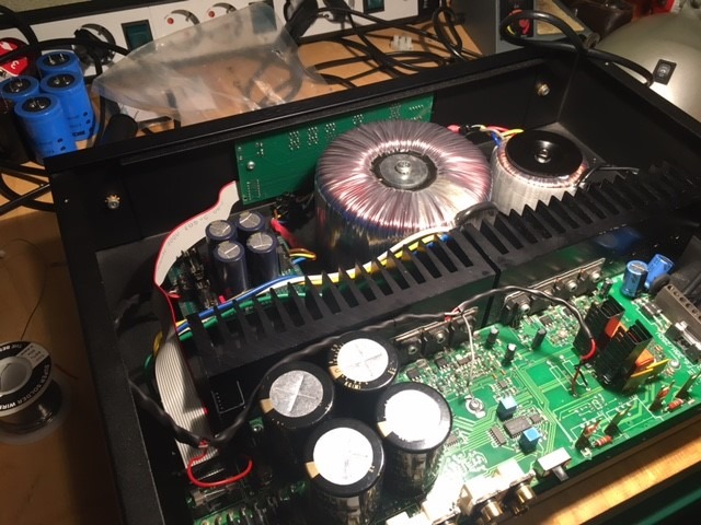

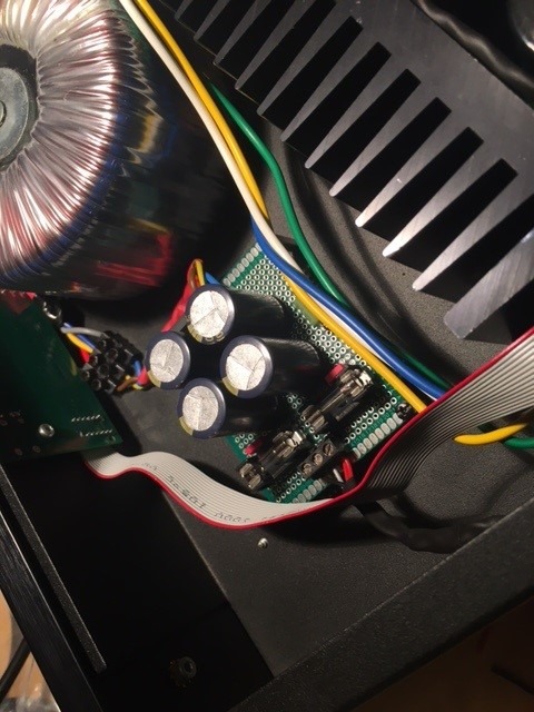

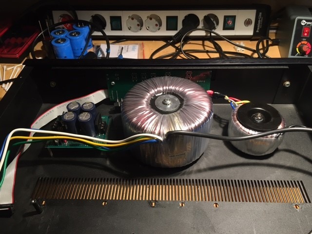

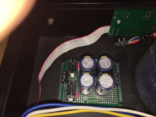

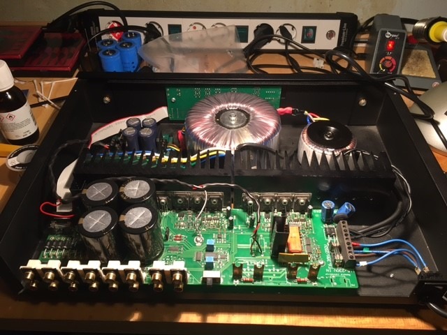

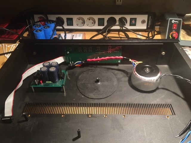

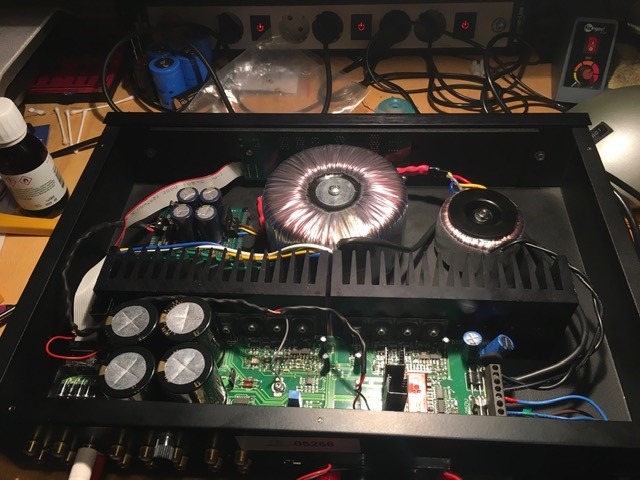

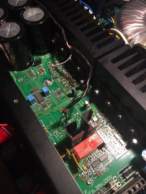

Hi Paul
I did some repairs to my Thule IA 100 a couple of years ago.
please see
https://www.diyaudio.com/community/threads/thule-ia100-dc-on-output-when-hot.363092/#post-6451215
For the start of the process
I ended up making a separate power supply for the pre-amp with its own trafo, bypassing the resistors to the voltage regulators (LM317 and LM337).
I also added heatsinks to the voltage regulators just in case.
I agree with you that the input from tiefbassuebertr was adamant in this, but also the input from Rallyfinnen was invaluable.
The amp has now been running flawlessly for a couple of years
Attached some pictures how my installation looks
