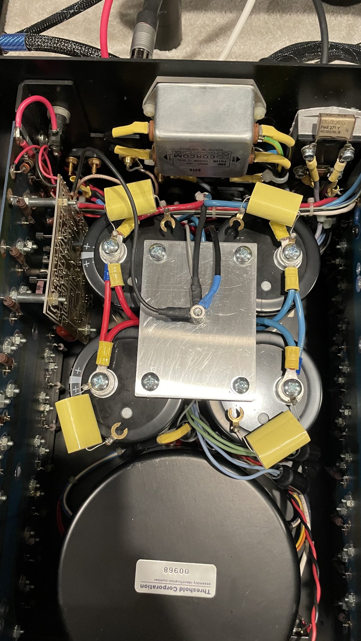

power caps were replaced with 47000 Epcos 100v
Amps were previously modded with power filtering.

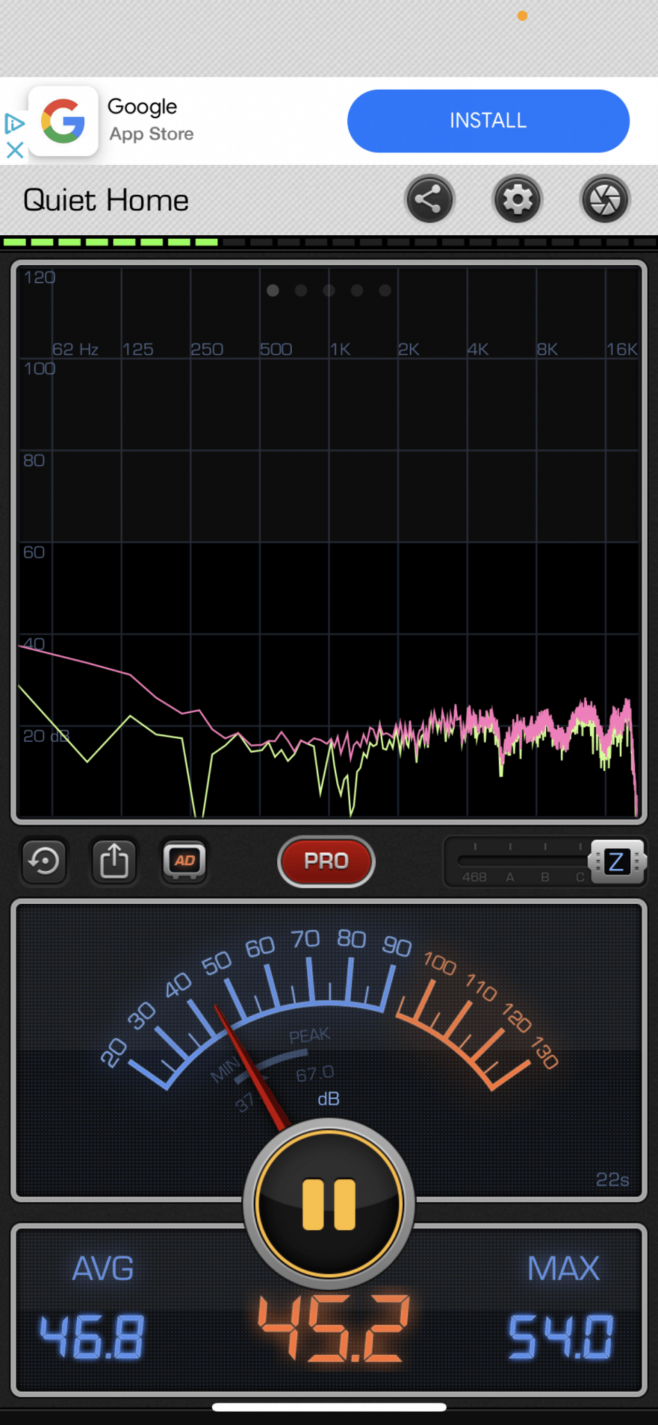

Power on, no RCA input connected = no hiss, dead quiet.
As soon as I connect RCA from various sources and different cables I am getting a hiss in both speakers. Tried from preamp, directly from 2 DACs and each one provides hiss. All upstream components have been used with other amps and there was no issue.

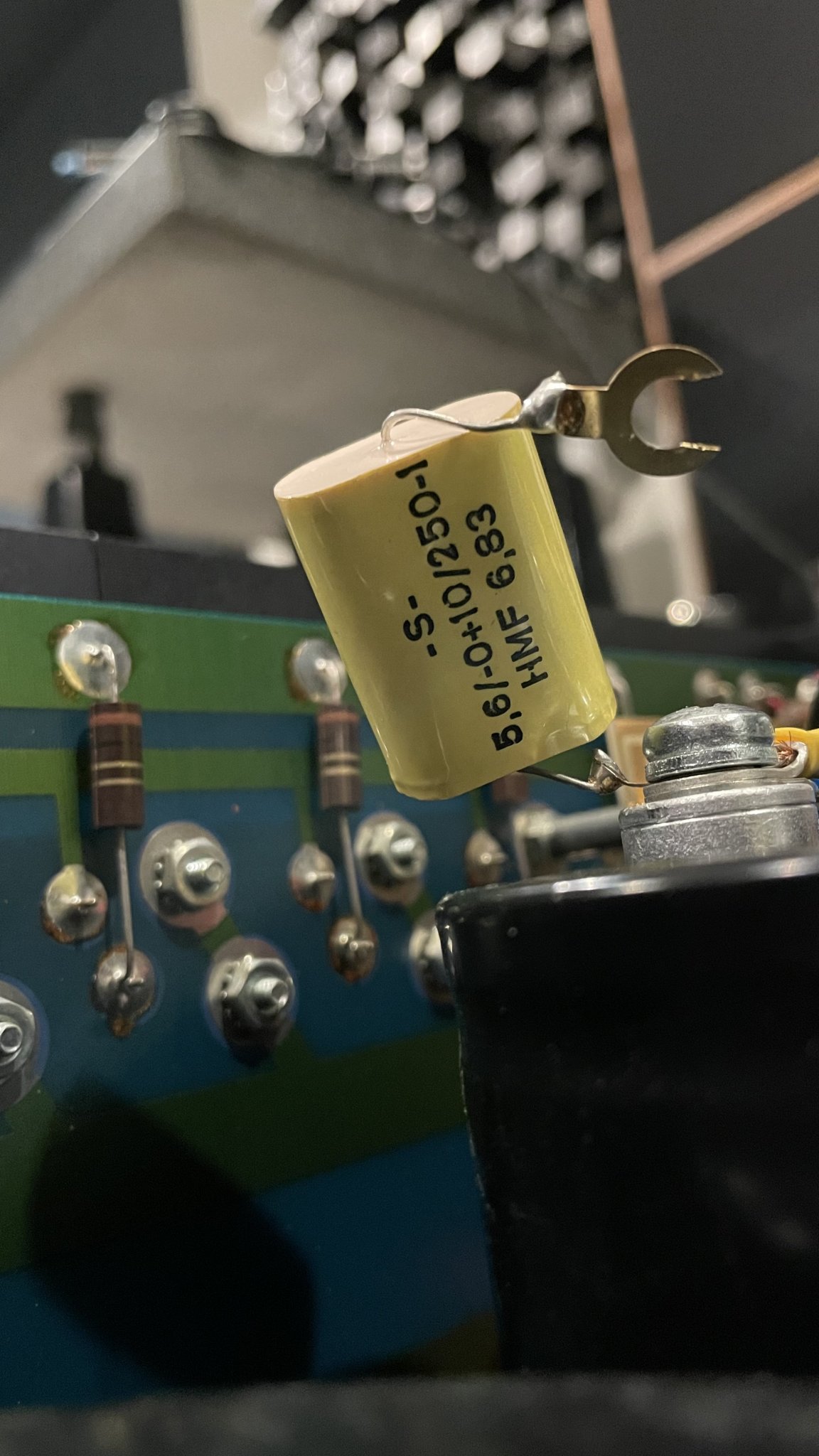

1) Disconnect small yellow parallel caps ( value of the caps and brand unknown as they were installed years ago)
2) tried grounding the RCA input to star
3) move pcb ground away from power filter in the back.
no impact on hiss.

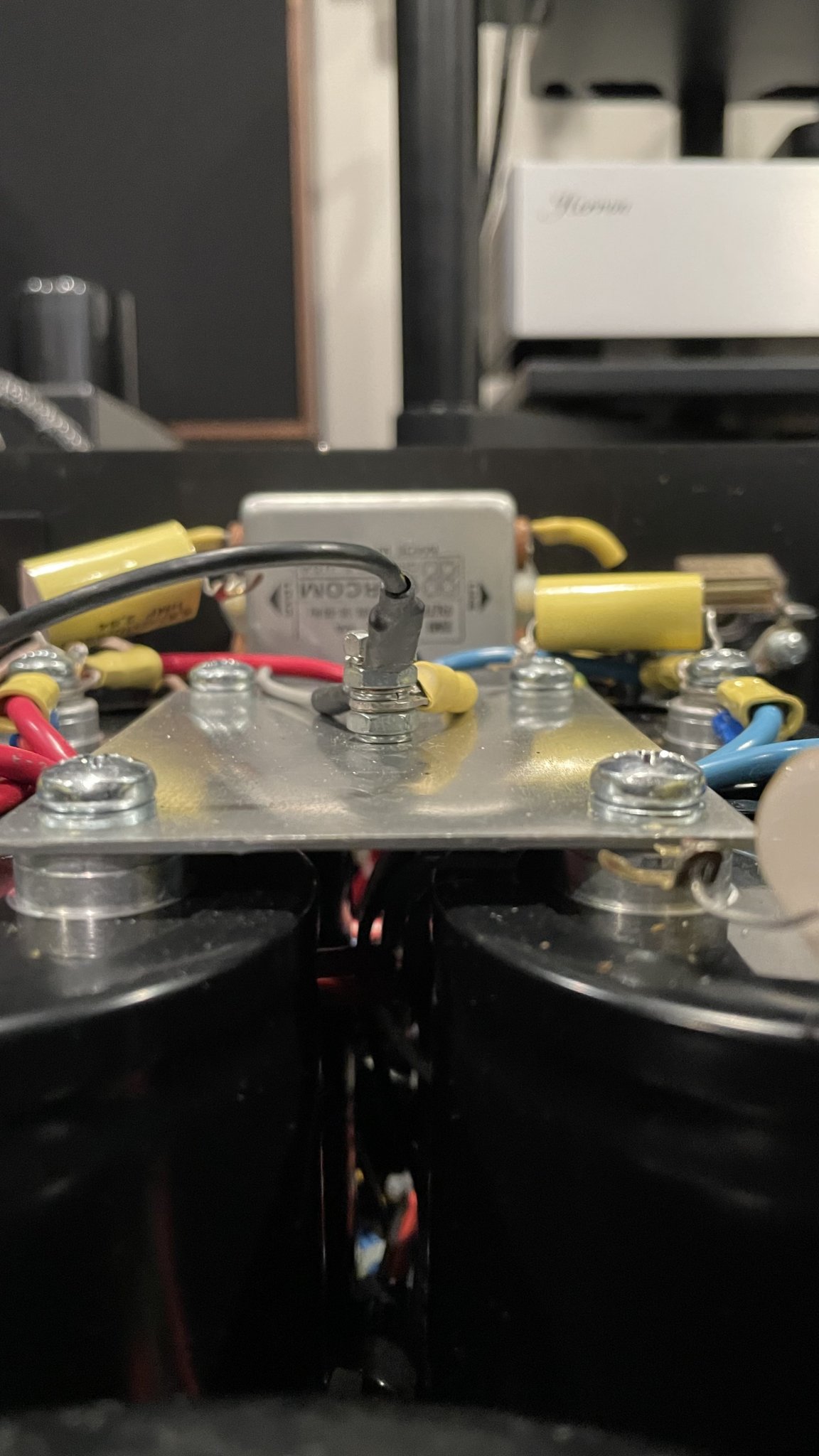

The aluminium plate that are used for grounding for the caps.......is good electrical contact ensured by using shims that "bites" into the aluminium?
If amp oscillates it should be easy to see using a fast scope at speaker out?

Define "hiss": is it a continuous low frequency "hum" (correct term), or is it some random statics like on a radio between stations?
If it's "hum", it may be a ground loop problem: disconnect both RCA cables from the source, it should go away. A temporary fix is to remove the ground pin of your power plug, and a permanent fix is to have someone install a ground breaker inside the amp.
You can measure using a DMM set to Ohm (or beep) if you have "zero" between all the cap screws and also to the center ground screw.
I would have used star-shims that "bites" into the aluminium to be sure it penetrates the oxidation of the aluminium.

Definitely not "hiss", but a "hum" with a surprisingly large harmonic content for a ground loop.
Still worth trying the ground pin removal. Att.!!! This can be illegal in some countries as it may kill you!!!

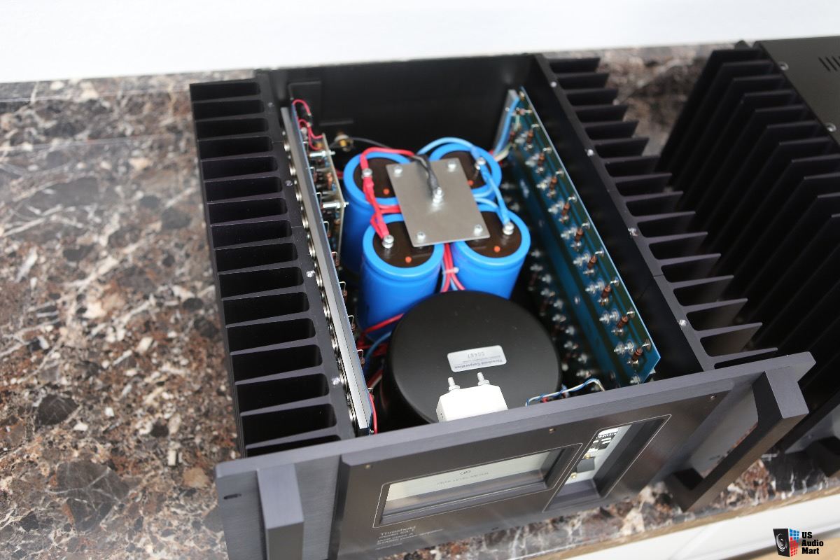

I don't have the skills to tell you how to fix the problem, but I can tell you this: If they were mine, I would remove all the mods (rectifiers, filter and truckloads of xtra wiring) and bring it back to stock.
You would still be in sonic heaven.

Fully agree with Baejisman,
I just renovated a set of SA/1, new caps, replaced the tantalum just for good measure. The old electrolytics were still alive but the ESR of course had increased significantly. While in pristine condition there was some surprises which needed attending to.

It can be seen as an fluctuating current consumption. The SA switches also have an internal peak current protection, but it is not an inrush limiter - which is adviseable to install for installations with RCD and also when increasing the capacitance - upgrading to a similar sized can e-cap will easily get you x3 in capacity ;-)
The input filter looks suspiciously old and the Rifa's on the - bridge? looks like the Rifa type commonly known as "fire crackers" this could of course be a newer and improved model....
Thanks for all the feedback. After trying various possible solutions as outlined here and many other threads the conclusion was a ground loop that only occurred with some cables and when specific components were plugged in. An Emotiva cmx-2 fixed the hum/hiss. Amps are fine.
I have one more last question. I have read from previous owners that they used the bridge caps on top. I don't know what the yellow ones are, but they put more emphasis on the mids and make the amp sound warmer. What types of caps would one use use to experiment with the sound? What would give clearer highs or a punchier bass if this is even possible?
