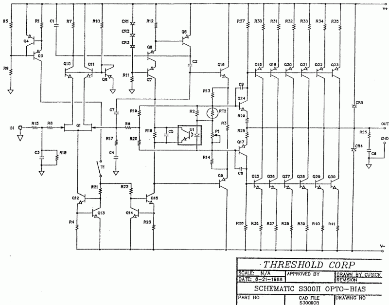

I have attached s300 power supply schematic.
Has anyone had problems with the switch/breaker and what is the criteria for selection of the 2 capacitors 0.01uf off the switch?

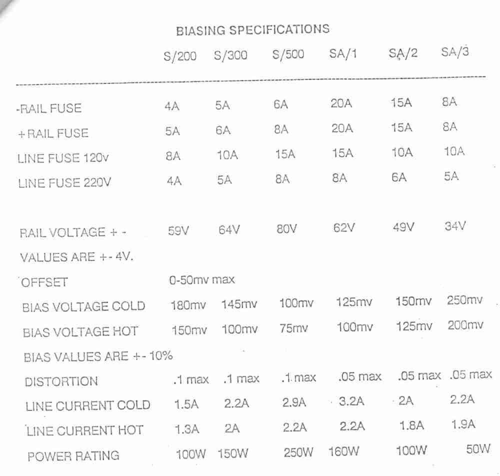

Threshold S300ll Bias Adjustment
Nellson: Hi, It seems that you have schematics for the Threshold S300 ll. I'd like to set the bias and the DC offset but I'm new to this procedure. Are the blue pots the bias adjusters? Are there DC offset pots anywhere too? Please help- I'm a "Nervous Nelly" about this. Thanks, Wayne

Re: Threshold S300ll Bias Adjustment
Here ya go.
Cheers George

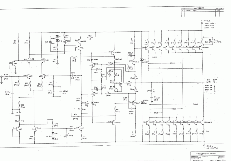

SA/12e and S/550e
Does anyone know parts different between SA/12e and S/550e ?
I try to reduce S/550e bias but I still can't do it ! (now 125mA/transistor and I need only 25mA/transistor)
P.S. I don't have S/550e schamatic but I have only SA/12e schematic on hand 🙂

Hello, can someone send me the s300-II power supply and the main board schematic?
