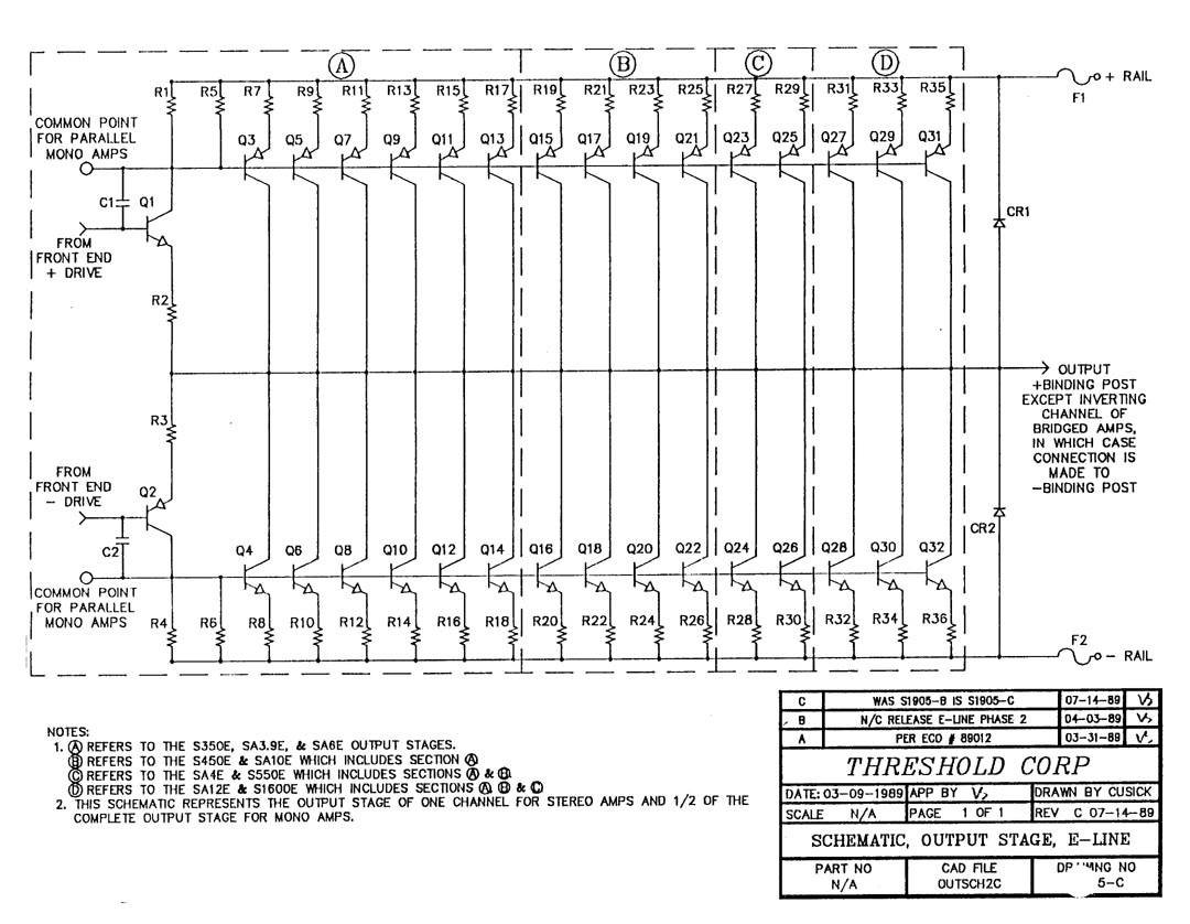

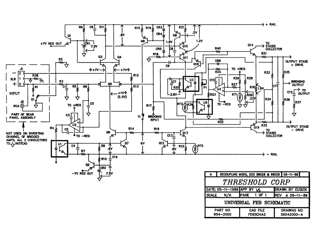

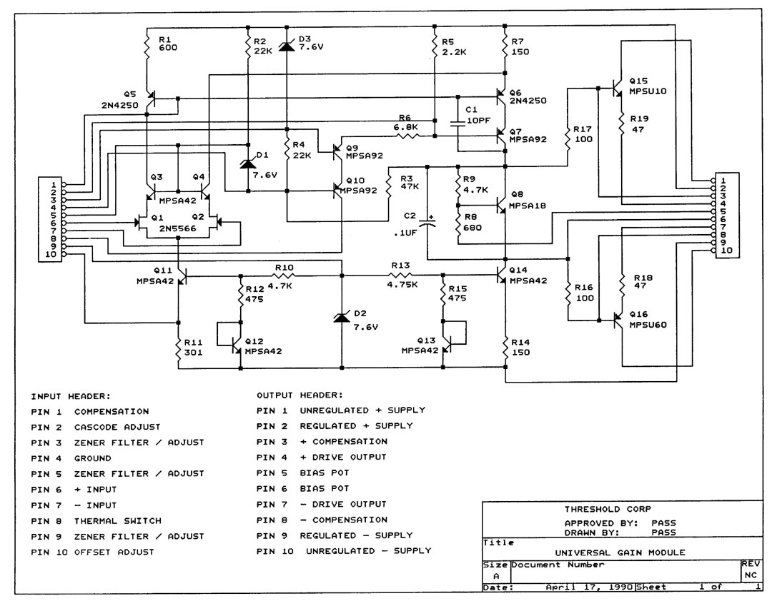

Does anyone have the schematic and or service manual for the Threshold S/550? I was told that these amps normally came with a wiring diagram in their original owner's manual, but the manual for this one has disappeared a long time ago. This amp has high (1.5 volts) offset voltage on one channel while the other is fine. The amp does power up and everything, it is just that the one channel with the offset voltage issue is not working correctly.
These will probably be helpful.

Thank you Mr. Pass. I have been a huge fan of your designs. You design good solid amps that just plain sound right. I am really looking forward to getting this amp up and running correctly. It certainly is a work of art. Again, thanks for the schematics..
I have this monster all apart. So far no bad output transistors. It powers up and rail voltages are even and look correct. Ditto for the feed to the two circuit boards. One channel is rock solid with a few milivolts of offset voltage. The other channel is another story. It works but sits there with about 1.5 volts of offset voltage. I'm thinking possibly that IC which is Q5 may be funky, or the bipolar differential pair Q3 and Q4. I don't really have a way of testing that IC, but voltages are not perfectly balanced in and around that circuit. I know that in the old Marantz 22xx Receivers I work on, if the differential pair is too far out of whack, the thing will not be stable and you are constantly tweaking that offset voltage pot. Anyway, it looks like an interesting project. At least it isn't as heavy to move around as the McIntosh stuff I am usually working on. Always a silver lining to every cloud!
Q3 and Q4 are merely cascodes, not likely to be the problem. Have you
identified that this is one or the other of the two front end schematics?
If there is an op amp for DC stability, check to see if its output is approaching
one of its rails, + or -. Note which, and also the polarity of the output offset.
This amp has the front end with all the IC's. I'll make those checks you mentioned. I am assuming U2 is the opamp you are speaking of. It makes sense that if that IC was not sending out a balanced voltage to the gates of Q5, things would be a bit off at the speaker terminals.
I changed out the dual FET IC and the offset voltage dropped by a good 40%. But it is still over 1 volt. I have ordered some LM308's and plan to change that opamp out next. Voltages around the dual FET and that opamp are not perfectly balanced, but not that far off either. What is an acceptable DC offset voltage at the output terminals of these amps?

I checked the offset voltage and it went down a lot after replacing the NPD5566 dual FET chip. Went from a -2.1 volts to -1.3 volts. I replaced both M42 transistors and that LM308 opamp and it is now as -1.17 volts. If you flip that balanced to unbalanced switch on the back of the amp, the offset voltage will drop to - .92 volt in balanced mode then go up to -1.17 volt in unbalanced mode. Output transistors all tested good. This offset voltage issue is something I have seen in a lot of older complimentary and direct coupled transistor amps I have owned. It never seems easy to fix.
How critical are those 7 volts off the M42 transistors as well as that 7.5 volts across that zener diode? Should the 7 volts off each M42 be exactly the same ( like 6.8 volts for one and 6.8 volts for the other as opposed to something like 6.7 volts for one and 7.0 volts for the other)?
Just for testing purposes and to see certain voltages, (which are all but impossible to test with the board mounted on the heat sink assembly) can this board be removed and run by it's self on an external power supply so I can check for voltage problems at every component? Although changing what I did has made a marked improvement, the amp is still no where near where it should be with respect to offset voltage.
I got both channels working properly. 17 uV offset voltage in the left channel and 11 uV in the right channel. ( was over 1 volt in one channel and over 2 volts in the other) What I found was that it was a combination of things. In both channels, replacing the Q5 chip (FEt differential pair) brought the offset voltage down by about 50% or so in both channels. But it was still too high. I then replaced the opamp U2 (LM308) and that brought the offset voltage in the left channel to 17 uV but the right was still too high. I found that the resistor R8 had a bad connection (because someone else had worked on this amp and not soldered the connection properly). Once that was fixed, the amp worked correctly. I did replace Q3 and Q4 in each channel and it dropped the offset voltage a few more uV to where it now is. I only have about 20 minutes playing time on it at present, but so far so good. I need to now find out how to bias this thing and what the setting should be. But for now, it runs cool enough and sounds quite nice. I am driving it with a similar vintage Threshold FET preamp. Very nice combination.

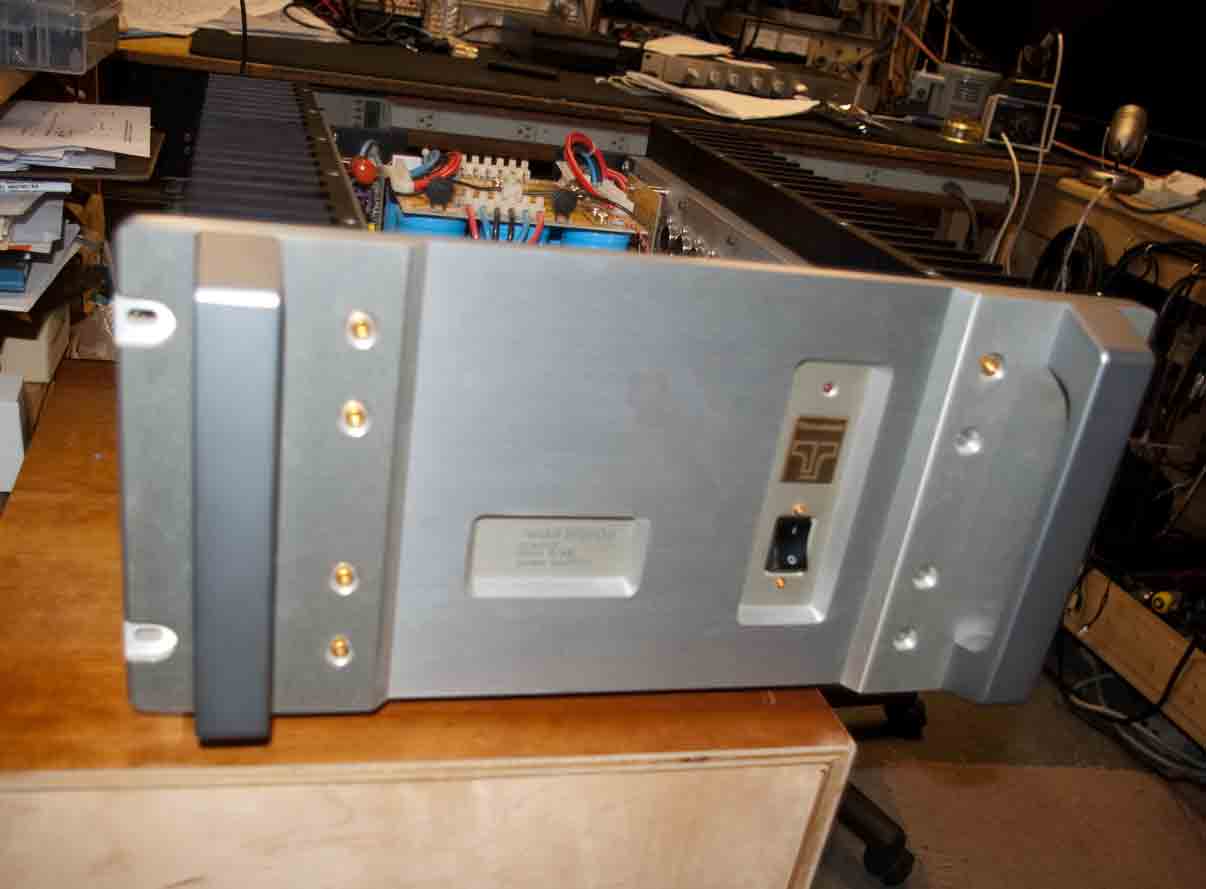

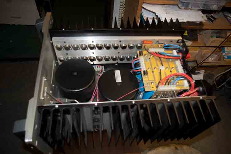

Ok, I'm going to try and upload a couple pictures of this amp. It has been playing happily in my shop for the past week and a half and sounds great. I want to thank you for all help getting this guy up and running again. This amp is a real work of art. Oh, my friend dropped off the S/A 4 so now I have another to fool around with. Cool.
This may be an odd observation, but it looks like the S/A4 is the same amp as the S/550e, but with different biasing and rail voltages. The circuit boards are virtually identical with the exception that the differential pair IC for the S/A4 is a 6 pin TO71 case while for the S550e, it's a DIP 8 pin. Still, it's the same number and dual FET type. I only have the one channel working on the S/A4 (The other whole heatsink assembly is completely removed at the moment). Someone had tried their hand at fixing this guy unsuccessfully before. Anyway, I need to get this guy working since I'm really curious how this class A amp sounds. These amps are built so cool. A couple dozen phillips head screws and 8 allen screws and the whole thing comes apart. Nice. Man, those heatsink assemblies are heavy. Lot's of thermal mass there. Oh, I work on hifi gear as a hobby. Actually build some of my own amps and speakers. It all started because I was so sick of the crappy quality of most consumer electronics and because I just can not afford high quality amps like these Threshold amps. So I started picking up basket cases and fixing them. Also built my own tube amps because most were over priced and out of my financial reach. Now I also fix them for others since no one wants to work on these big amps around here. Must be something about an amp that is big enough to dim the lights when you use it that intimidates people.
