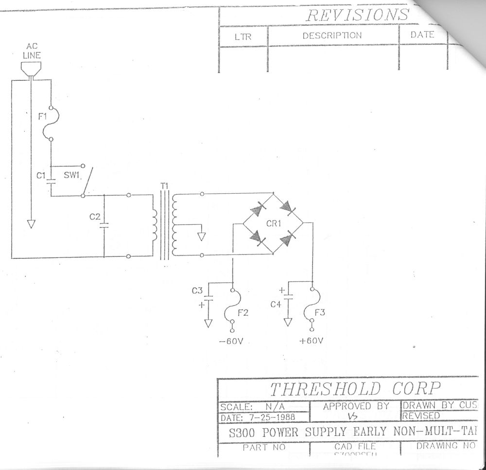

Can someone please tell me how to fix the power supply on a Threshold S/500 STASIS Power Amplifier? I have some schematics, but they're general overviews for several later designs. I need the specific technical information on this particular model. Hopefully, someone can tell me the voltage, tolerance, and bias.:smash: :xeye:

Can you be a little more specific as to what's wrong? Honestly, it's unlikely that the power supply itself has died, unless you've got an old cap that's given up the ghost. There's not much else to screw up. There's a power transformer, bridge diode, and caps for each channel. Nothing fancy.
I've got two S-500s and have done a little of this and that over time. It's been a while, but I seem to recall that the S-500 rails are around +70 or 75V. The bias is set, not so much by voltage, as by the temperature of the heat sinks.

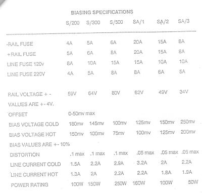

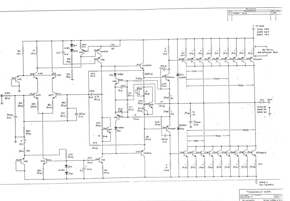

What do you think is the correct S500 bias:
the chart (#4) says 100/75 mV for S500,
the schematic (#5) says 20 - 30mV for all.
Think it's a pretty big difference.
Assuming the voltage across the 1R emitter resistors is meant...
Gerhard

Hi, Did adjusting the bias to 100mV across the 1 Ohm resistor on the emitter side get you to the correct temp?
Just checked the voltages:
10 sec side is apx 100 mV
5 sec side is apx 130 mV
Think to follow your advice and reduce to 100 mV.
