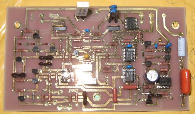

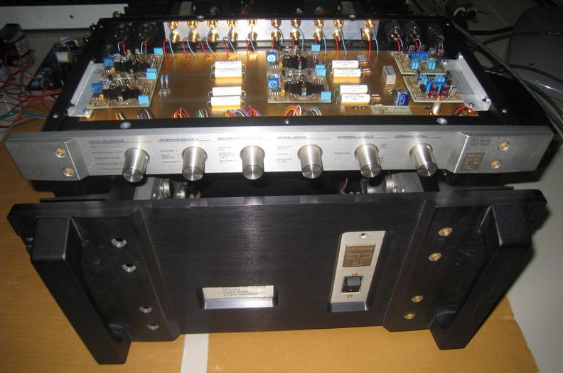

Anadigit, that looks like it could be the original! You did that board? Good job from the looks of it, great work! So are you building a compete S/550 from scratch? That's a hell of a tall order. Good luck. Do you have pics of entire amp, I saw the output section pic in your last reply, did you make that too?

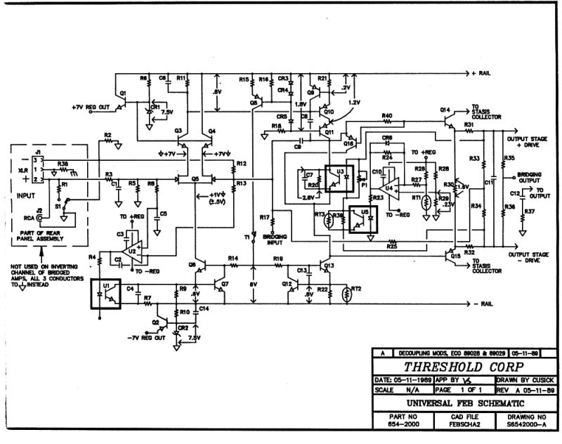

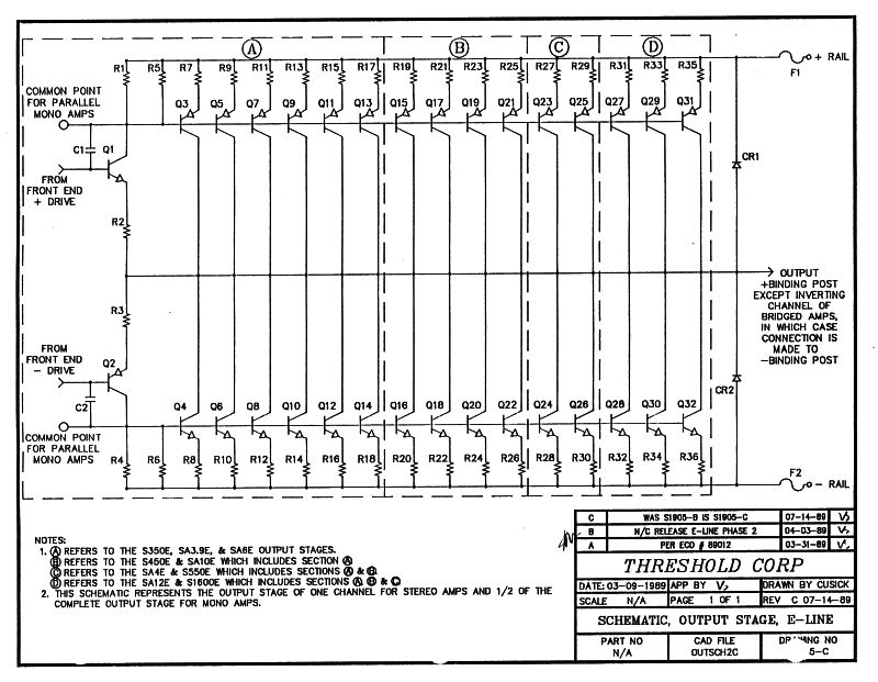

No, Geoge your schematic that's not S/550E, it's only S/550.
Take a look at OPTO of them !
Now I have original S/550E on hand, too
I took a photo from scratch S/550E and my Threshold Fet 10/E , I'm never build with a large or huge heatsink (it's only my plan)

Thanks George, front end schematic tells me a lot about what to look at. Would really like to converse with someone who has experience setting up one of these, bias, and offset. They just really don't seem stable enough for me to believe that there is not something wrong still. Maybe I'm wrong, hope I'm not, but willing to be wrong and get schooled. Again, thanks for taking time to send me prints. Stevie🙂

Hey ANADIGIT, so I guess it may take a while for me to learn how to read between the translation lines to understand your posts completely so here goes...That amp in last photo you built the "insides" of it? Then put it in old amp case? Let me know. Stevie
