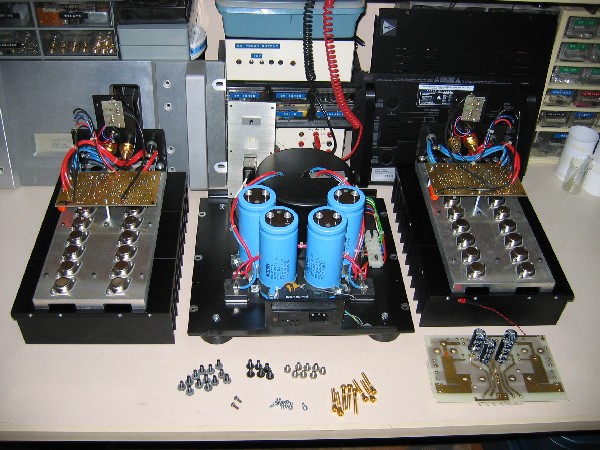

I am using a Pooge2 modified DH200 for the mid/highs right now. Figured it was a good time to recap my S350e now, as it "came apart" 🙂 Mods would be very easy now. Once this one is done, I can move onto the S500e, as funds permit.

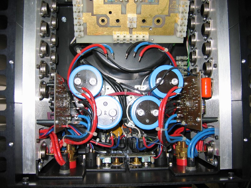

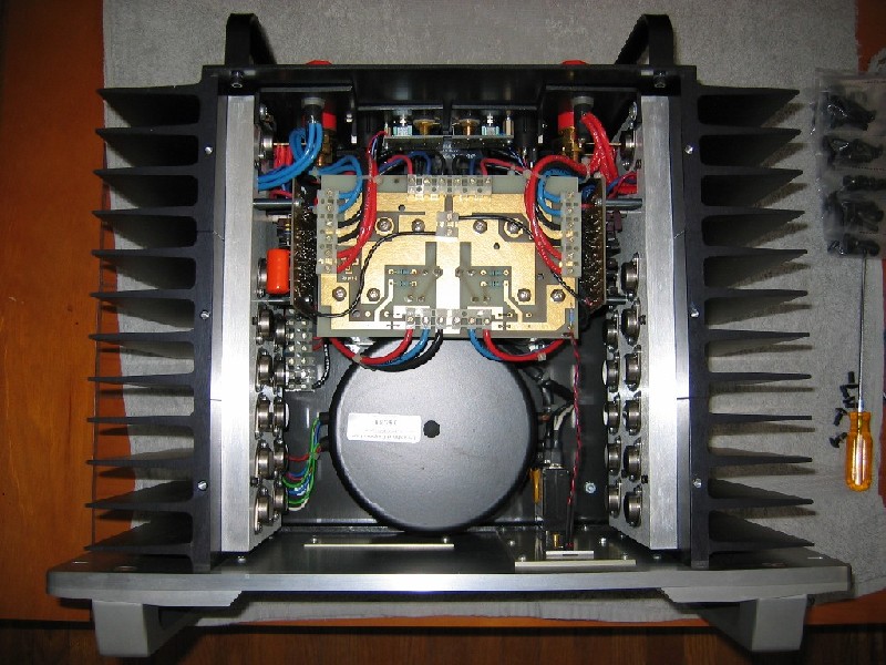

I ended up replacing all of the electrolytics in my S350e, and added Vishay MKP1837 .01 mfd bypass caps, it did make a very noticable difference in the top end. I will be hanging on to this unit now as a backup unit for mid/highs.
I also have an S300 MK2 that I replaced the electrolytics in, as well as adding Vishay MKP1837 and some used Wondercap bypass caps, and I also increased the large ps caps from 29K mfd to 45K mfd caps that I had on hand. I brought it over to my buddies Infinity RS1 system and it easily outperformed his stock S300 amps. About 6 people were on hand to compare the units, and all picked the tweaked MK2 as superior in sound performance.
The Vishay MKPs are nice inexpensive bypass caps that anyone should be able to afford. The Wondercap Ultimas though are no longer available, so I am going to order some Sonicap Gen1s and Gen2s to try out.
