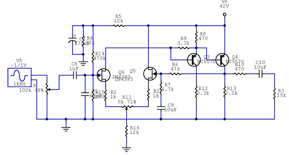

if your spks are on efficient side (92,94 DB/W/m and up) , then these preamps will suit your needs ;
look what's gain and max output voltage of these preamps ..........
then you can tell us ,too ............. 😉

well - in that case my schematic wasn't so bad .........
I estimate 7V at max
that Fet-10/hl must mean something as High Level...
marginwalker said:
not bad at all, btw can you post it or send it to my mail?
I think it's from here ...........
