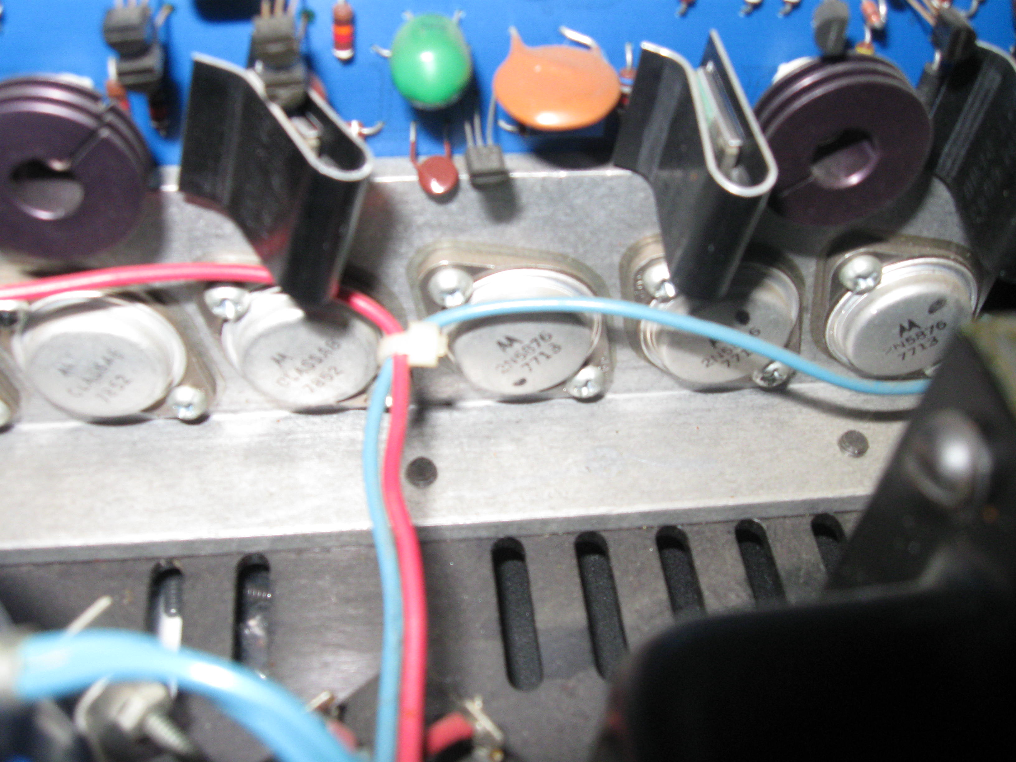

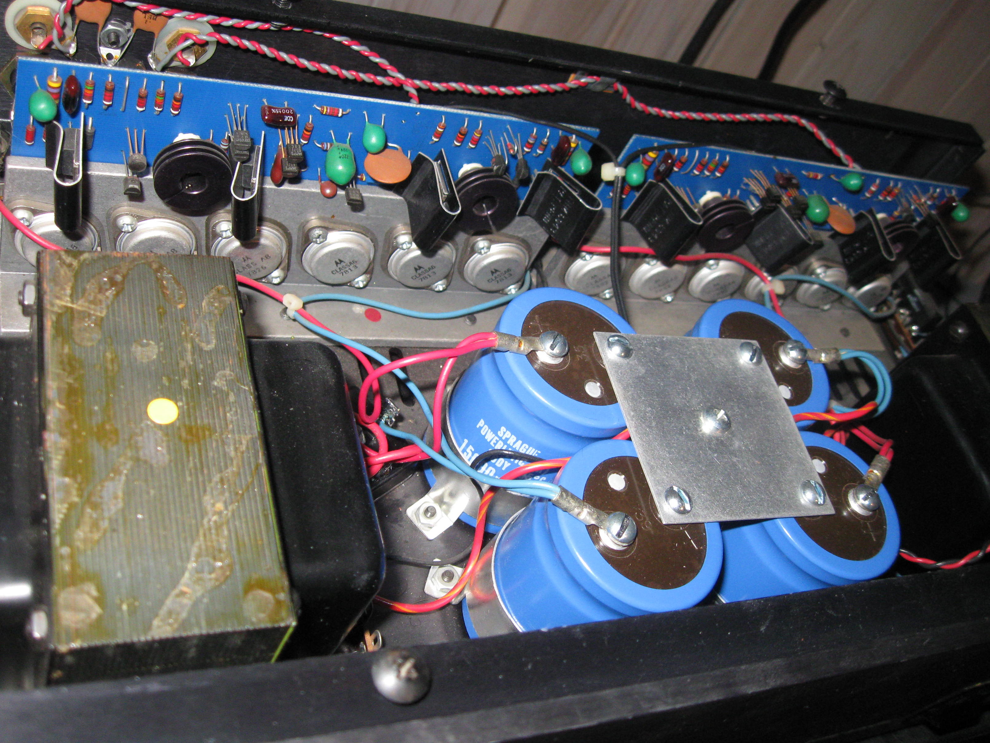

I have recently acquired a Threshold CAS-1. I have replaced the power supply capacitors, so it plays music again, but I had a couple of questions. It was suggested that I replace the existing tantalum capacitors (green blobs) on the board to a more modern electrolytic type. I also noticed that the output devices are not the same on both channels, one channel has 2n5876 devices and all of the others just say class ab and have a date code. Any thoughts?

The ceramics need to go too. You could also replace the bridge rectifier with a high speed or soft recovery type and how about some 1% metal film resistors for good measure.

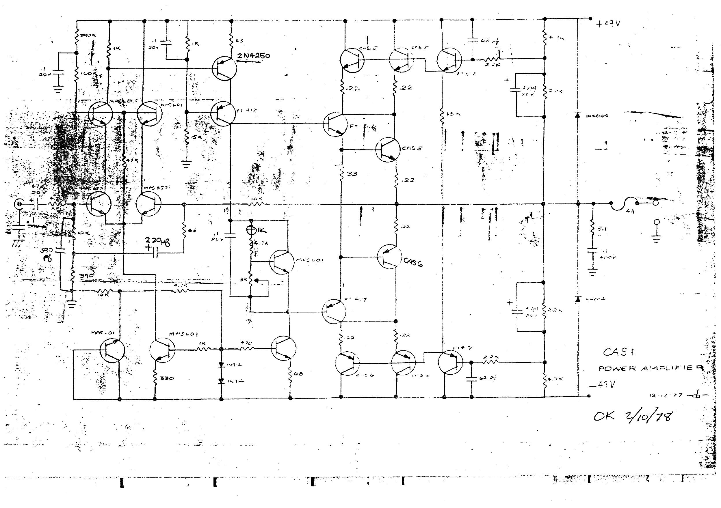

Decided to use one of my CAS1's again, but one channel gives a -0.6v thump when turned off - when +49v and -49v supplies discharge (after 1 second) to ~ 20v. Just replaced tantalums with Elna silk electrolytics and also the three 0.1uF caps. All my measurements with VOM show all 4 8000uF 50V capacitors to be the same - discharge rates, actual dc voltages and initial and final ohm readings with 1.5v VOM - 500 ohms initially slowly reaching >200Kohms after 1 minute. Have ordered new power supply caps. Any thoughts?
