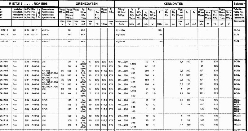

However, I am having difficulty with the two transistors marked as FT317 & FT417 located near the center of the schematic. On the actual physical board these are RCA-1A15 & RCA-1A16 transistors. Can anyone suggest a good substitution for these that is currently produced, any onsemi cross-over part? I'm pretty sure someone has dealt with this substitution with the other pass designs...

Netlist / Hugo:
Thanks for the data sheet, that should make things easier...
After checking around I am thinking that the onsemi D44H11 / D45H11 would be good substitutions. They are a different case style type than the original but I think they may be a good selection.

sulky,
I built this circuit (the 4000 version) 25 years ago and substituted the onsemi MJE15030 and MJE15031. As I recall the FT317 and FT417 were Fairchild parts and were unavailable even then.
GL
