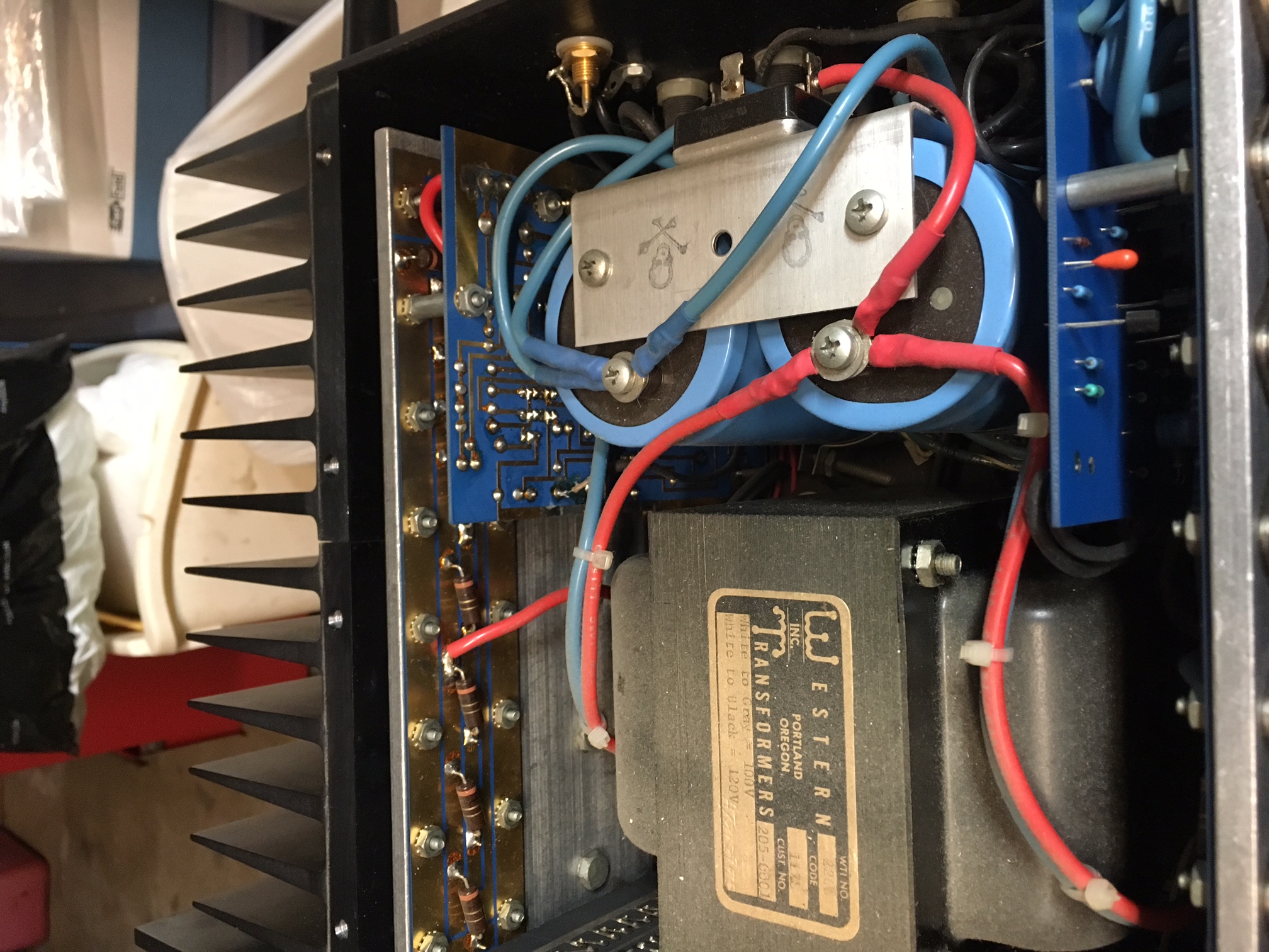

Sorry for being so tardy with my response but l
Wanted to get a photo of this unit, and hope you can tell me whether it’s
400a, what has been upgraded and by whom.

Sorry bad picture I was hoping it was a genuine “Threshold Skull and Crossbones”😀

You are totally right. I'm just old and forgetful.
If you look at the photo, you can clearly see that the output of the amplifier
comes from the cases of the TO-3 devices, which was true only of the
later Stasis circuits. Further, 1 ohm resistors were never used on 400A's.
Clearly it was updated.
