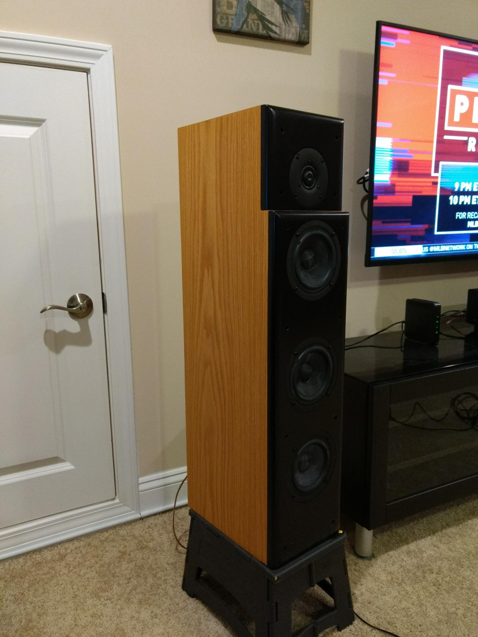

This project is long overdue. I started it in 2017 but a house move from Charlotte NC to Myrtle Beach SC intervened. I finally set out to finish it this fall.
It is a 2.5 way tower with three identical Scan Speak 15 cm woofers and an SB29RDC ring radiator. The two bottom woofers roll off around 300 Hz while only the top driver continues to the crossover point, currently at 3.0 KHz.
The woofer is the Special edition Scan Speak Discovery 15W/4524T02. I know some in these pages discouraged others who intended to experiment with this driver. With Troels Gravesen’s success with the Discovery line, I wanted to see how a 15W Discovery with an improved low distortion motor would do.

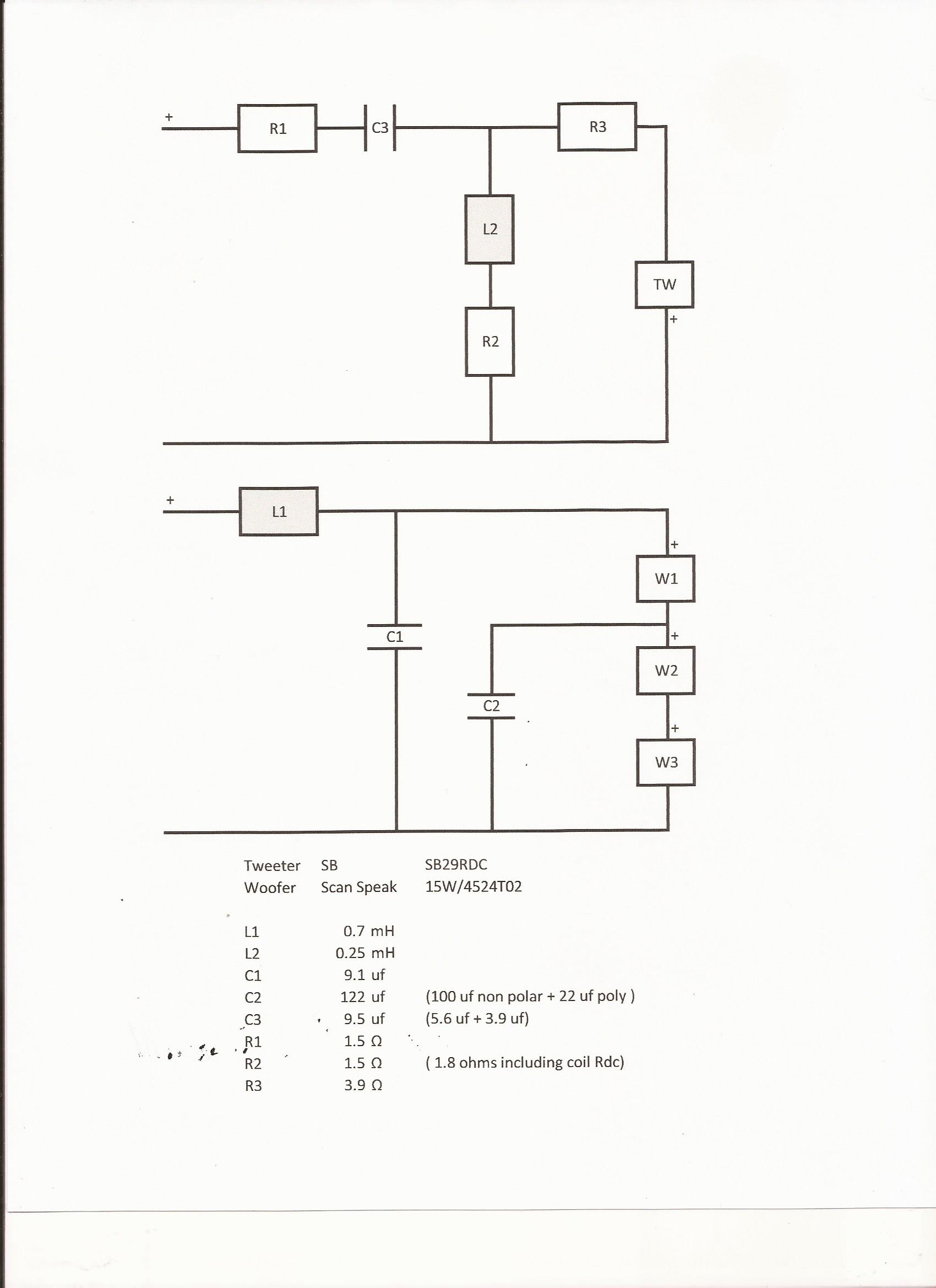

The design tools were CLIO Pocket for Measurements and LSP Cad for crossover and enclosure design. The crossover configuration is a second order LR. The woofer section 2.5 way is derived by a less common series connection with a large bypass capacitor across the bottom 2 drivers. There is a certain elegance to this design since the voltage summation across all three drivers always equals the value of the input coming from the crossover. It does not however, compensate for baffle step the way a parallel arrangement can. I suspect that some successful commercial designs use this concept.
I was surprised by the high frequency performance of the Discovery woofers and the resulting simplicity of the crossover. They seem far smoother than the smaller 12W version, but not quite a 10F. I expected more complexity to deal with HF irregularities but some additional planned components zeroed themselves out in optimization. The low inductance motor definitely helps also. It is still a work in progress but the attached schematic is where the design stands at this moment.

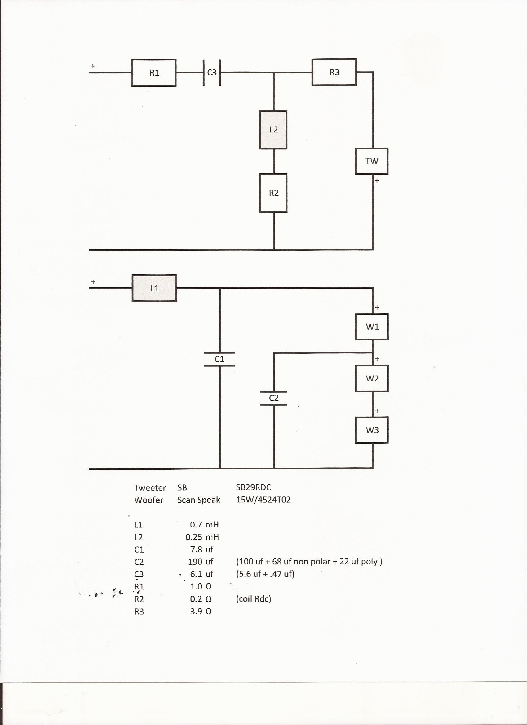

Attached is the latest Revision of the crossover.
I am very impressed with the Scan 15W/4524T. The response is very smooth and flat. I was prepared for a complex crossover with RLC filters and RC bypasses on the main inductor. The more I worked with it, the extra components just faded out of the picture. This woofer just does not need much to work in a nearly ideal LR2. It sounds clean right up to 3 KHz. The first slight deviation from true LR in the stop band occurs at 6-7 KHz at about -15 dB from reference level. The .5 way design with the bypass cap around the lower woofers just plain works. Too bad this driver is a limited edition. I think it is a cut above the other drivers in the discovery line and a serious competitor to more expensive Scan-speaks.
I am not too sure If I will stay with the SB29RDC. Response at the top is not as smooth as I expected and I can hear and measure a slight difference between channels. I am still trying to determine how much of the response anomalies are diffraction or in the driver. It sounds very open but just a bit unrefined. The dip at 3K and bloom around 800-2000 Hz is a bit more pronounced than the factory measurements indicate. I may try my old Scan 9500 or the Scan version of the XT25. Another possibility is the Satori TW29RN which seems to have a better controlled low end than the SB29 or regular TW29R. I don't know if the new SB29RDAC with the new front plate is any improvement over the older version. I would like to hear from someone who has tried it.
