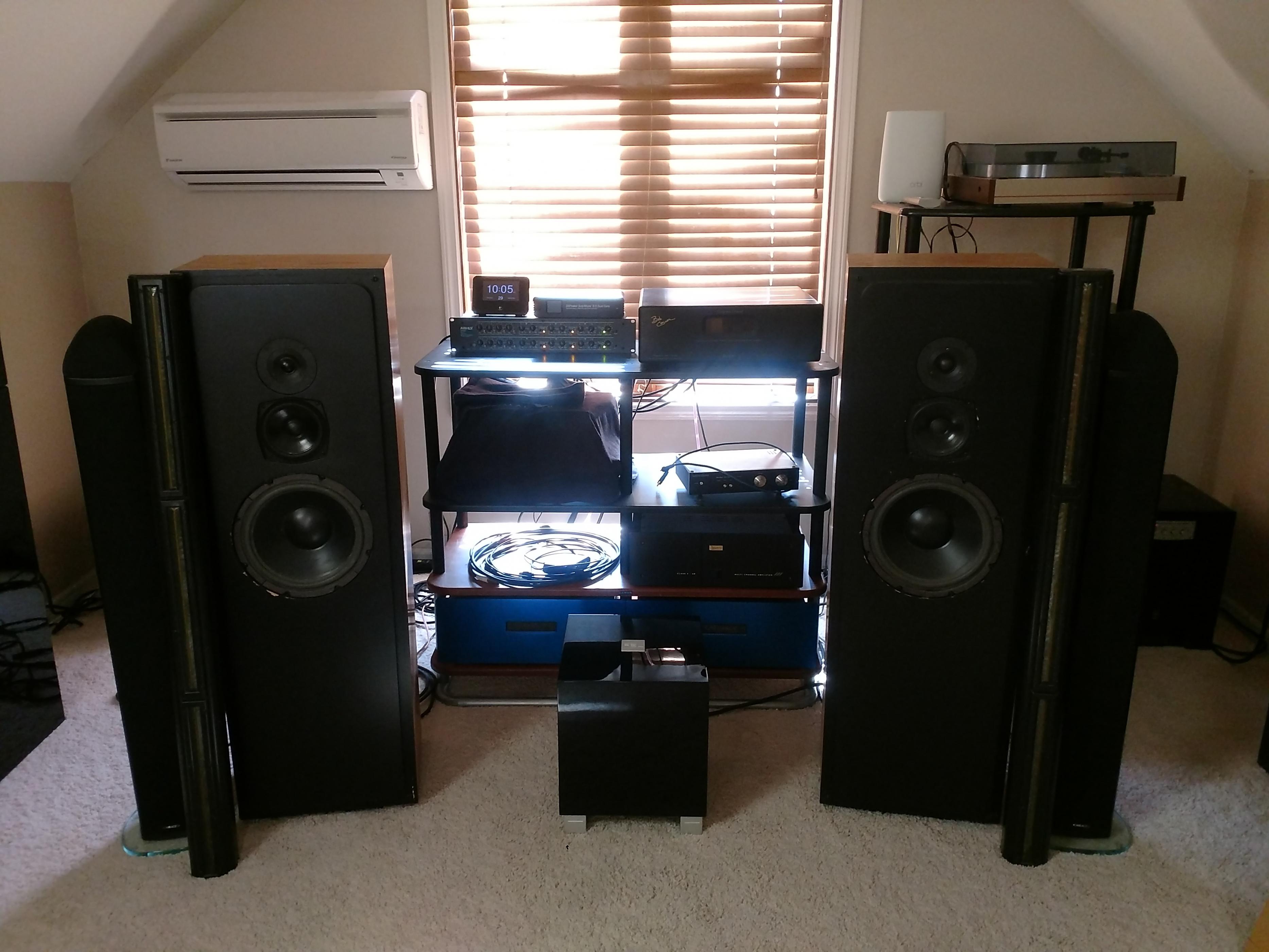

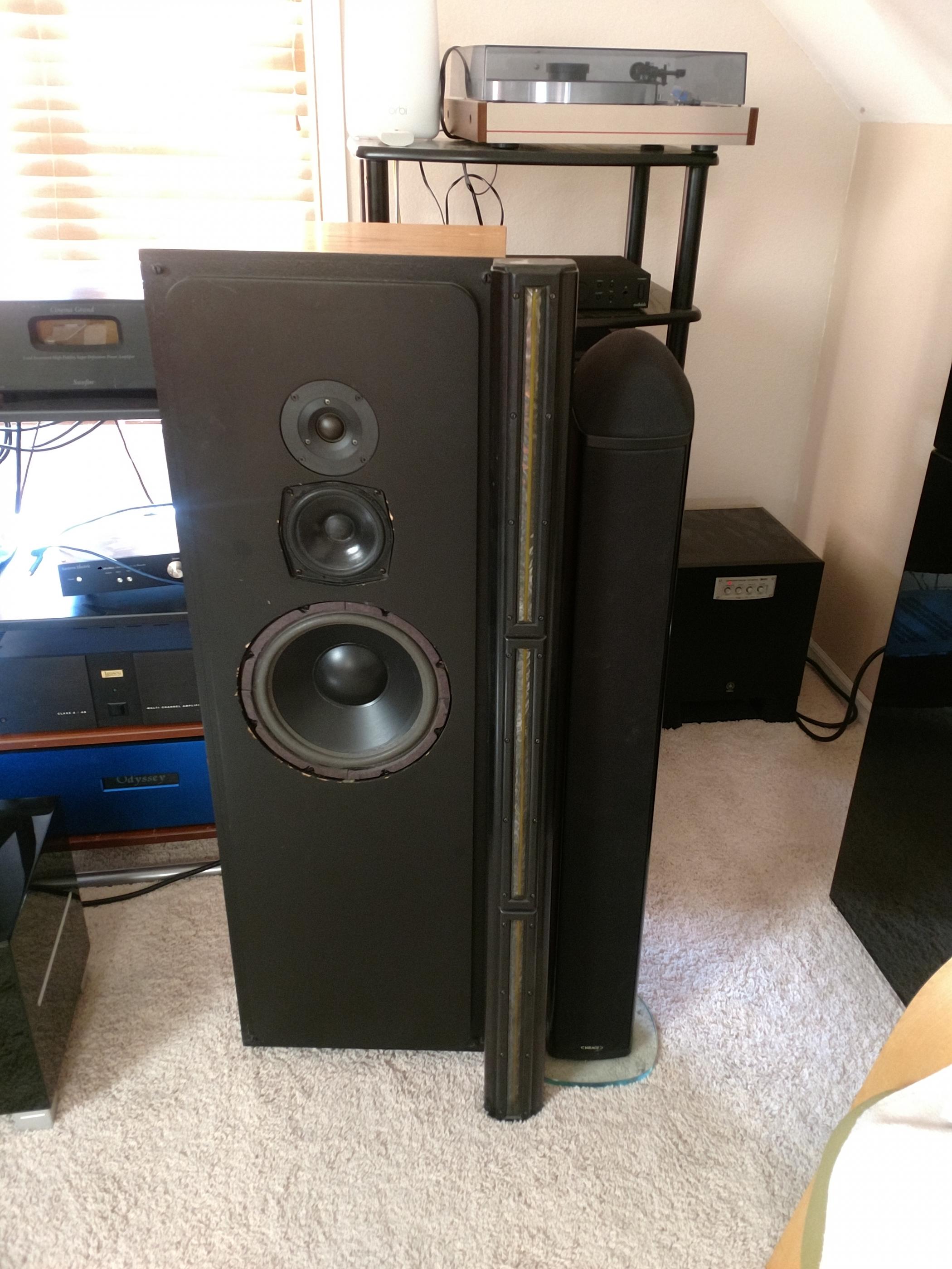

I had newform 645s for a few years. Here is some of what I learned about them through several years of experimenting. The best way to go is to bi amp with a low level cross over IME. The stock 645 had 2.7 ohms of resistance in series with the 2 paralleled SS 8545 drivers to match the sensitivity to the ribbon. Not a real good use of a high quality driver IMO. Big improvements were had using low level cross overs and bi amping. The ribbon driver itself weighs something like 45 lbs and is basically a long steel tube open on one side. If you fasten it directly to the top of the box it tends to ring IIRC at about 220hz. Some isolation is definitely needed.
Although rated to go down to 1khz I had better luck with higher crossover points. I always heard a coloration at lower crossover points. I think a first order crossover is too shallow for high output levels when set at 1khz. I used a Marchand Electronics 4th order LR crossover which seemed to work better, but I never really got the sound I wanted in my mid sized rectangular room. Eventually I sold them and moved on.

I ended up building better braced boxes than the stock ones. The bracket is usually mounted to the inside of the box with silicone caulking to give some vibration isolation but given the heavy weight of the ribbon it still needs to be fixed securely. I put sorbothane under the ribbon and also between the ribbon and the mounting bracket. I also isolated the mounting bolt from the bracket with a rubber washer and I machined off the threads where the bolt would have contacted the bracket. So the bolt did not have any direct contact to the bracket/box.
