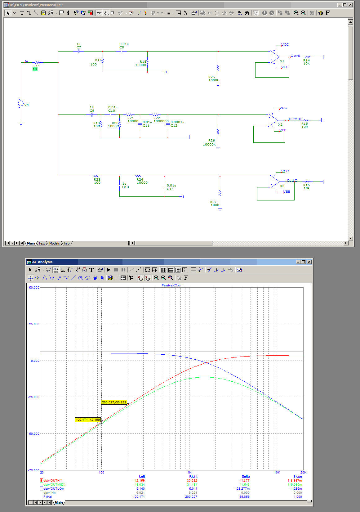

You can do any order with just 2 opamps. Silly enough, you can do without opamps too, as long as your source output impedance and amplifier's input impedance are known and stay constant.
Make passive networks as you do with loudspeaker passive crossovers. 🙂
You can live without inductors - just use RC filter, and calculate the following stage as if it have input impedance of R+Rsource.
Gonna be messy.

3 opamps:
1. Input buffer
2. HP buffer
3. LP buffer
+ passive network in between.
You can go with 3rd order per single opamp in Sallen-Key way - 3rd order Sallen-Key Low-pass Filter Design Tool

Could you explain how this is done?You can live without inductors - just use RC filter, and calculate the following stage as if it have input impedance of R+Rsource.
Gonna be messy.
S3,
I don't need the answers I need the method to determine the answers.
Can you talk me through the 2pole High Pass shown?
C7, C8, R11, R17, R18.
How do you correct the component values for the non zero source impedance and the non infinity load impedance?
How do you arrange for the Q to come out at the desired value?

AndrewT, I've spent 2 evenings on the matter 🙂
First time i've managed to get the calculations work, but when i've dialed-in the 2nd stage, i always got -6db at filter's Fo. Filter's Q didn't vary much, something between 0.5 and 0.707, maybe 1.
Second time i calculated the transfer function for the circuit, simplified it to the
(s+1)/(s^2+s+1)
form, and then again i've got stuck 🙂
I tried to solve the equation for H=2, but got some unrealistic numbers.
I think it's the right time to google for help 🙂
(s+1)/(s^2+s+1)
